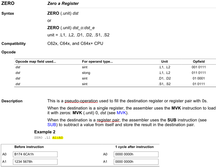

    0 Anonymous in reply to Archaeologist
    Archaeologist,
    From page 508, SPRU732J, TMS320C64x-C64x+ DSP CPU and Instruction Set Reference Guide, the operands and destination should be register pairs for ZERO to be translated into SUB?
    Zheng
  • I was trying to explain what a "pseudo-op" is, and I simplified the description for clarity.  Most users should not be concerned with what instruction the assembler chooses to implement a particular pseudo-op.
