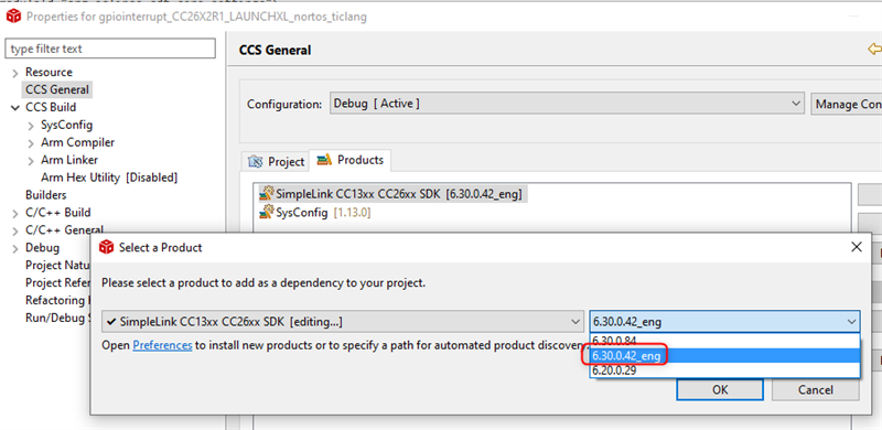

Does anybody know where (in which file) the following setting is stored? I would like to commit said file so that my colleagues don't have to make the same manual selection.

Thanks Santosh but that is just the available products installed on the PC.
I want to know which file stores the product selection for the project? I don't think it's in the .cproject or .project so must be a workspace file or CCS installation file.

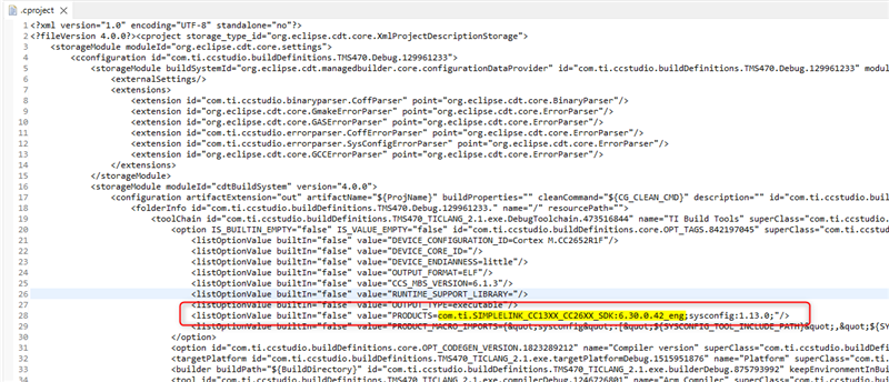

It should be in .cproject.
Example:
I set the SDK version to 6.30.0.42_eng:
the .cproject file for the project will update with this information:
ki
