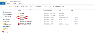

  • Hi George,
    The CCS can recognize the project only when it's had below project file

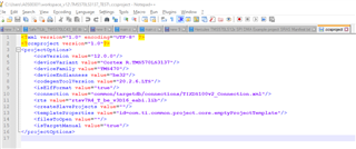

    This file contains the below information
    Why don't you create a new project using CCS and you can import the existing .cpp files to the new project?
