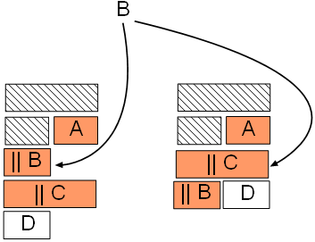

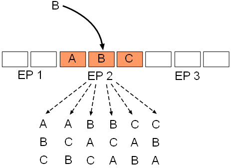

    This reminds me of another question: is it possible for branching target to be in the middle of an EP? It seems to me that:
    1. If the user writes C code and the compiler generates the assembly code, it is very unlikely that a branching target could be at the middle of an EP. The compiler should have made each branching target the starting word of the EP it belongs to. Is this true?
    2. If the user writes assembly code, anything could happen:
      1. In this case, the branching target might well be in the middle of an EP, not just of a FP. In the case, what does the CPU do? I tend to believe the ambiguity here is inherent: EP(A  || B || C) only contain the information that A, B, C are parallel, it can in fact be written in 6 different orders (the permutation factorial(3) ). If the CPU is designed to ignore the instruction before (in the storage order; there is no execution order here) the branching target, then although all permutations in storage order executes the same in normal situation, in this branching case they are executed differently. Therefore, it should be the programmer's responsibility to choose the right permutation.
      2. I don't know how rare it is to both (1) using assembly code (2) branching into the middle of an EP. But for logical completeness this scenario cannot be ignored.
    So what does the CPU really do, if the programmer writes assembly code and a branching target is in the middle of an EP?
    Zheng
  • Yes, it is legal (but generally unwise) to branch into the middle of an execute packet.  The compiler never does it.
    Yes, the preceding instructions are ignored, even if they appear (from the disassembler view) to be in parallel.  The assembler normally encodes the instructions in exactly the order they appear in the assembly code.   When generating compact (16-bit) instructions, the assembler may rearrange the order of an execute packet for better compaction, but will not do so if there is a label on any instruction in the execute packet but the first.

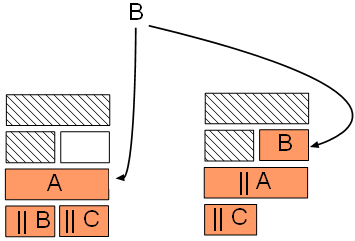

  • Zheng Zhao said:
    You mean this? In this case, not only the B is moved to in front of A, but the branching target should also change, isn't it?
    I don't know offhand whether the assembler avoids this transformation or whether it changes the label to point to B.  I would have to research the answer.  How critical is your need to know?
    The assembler has to assume that if a label is in the middle of an execute packet, then there is some branch, somewhere, which branches there.  It can reorder the instructions, but cannot move instructions that were lexically before the label to be after the label, or vice versa, because that would change the sequence of instructions seen when branching to the label.
    Like I said, branching to the middle of an execution packet is unwise, and not the least reason is because it is confusing.
