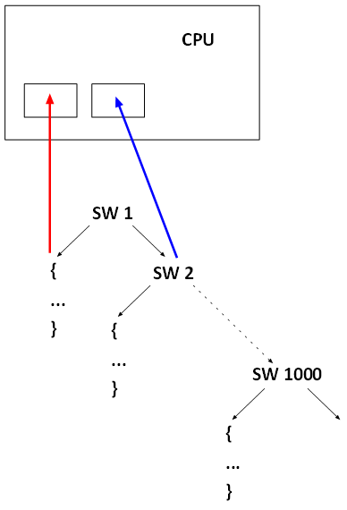

Alternative II:
Designate two special registers in the CPU for implementing this.
Why would we require two of them rather than one? This is basically because each branching, executed or not, can lead to two different new program counters / addresses - In data structure, two child nodes of a binary tree.

Case II:
SW 0
value = expression
Case value
SW 1
Switch 1
SW 2
Switch 2
SW 3
Switch 3
SW 1000
Switch 1000
To exclude the case of computed value before running (known at compilation), we further stipulate that value is only possible to be known at run-time, for example, if expression contains at least one user input term.
In this scenario, upon finishing of SW 0, there might be as many as 1000 new target address. But this is only an illusion, since the semantic tree is always binary. Therefore, storing two possible PCs as shown in the diagram below is enough. Each time a new breakpoint is reached, the debugger-emulator should update the contents of these two registers
With this scheme the same resulting can be achieved without “patching” the memory.

  • Zheng Zhao said:
    My question is how is software breakpoint in C6000 actually implemented?
    As far as I know, CCS will first save the opcode at the address where the breakpoint is set to somewhere else, and then replace it with a breakpoint opcode (probably a halt instruction). I believe the original opcode is saved in memory on the emulator itself and CCS keeps track of this so that it can associate the original opcode with the address where the breakpoint is.

    Ki-Soo,
    So it corresponds to Alternative I, "patching memory"?
    Zheng
  • Similar concept, though it is a different opcode that is written and i don't think it is an interrupt.
