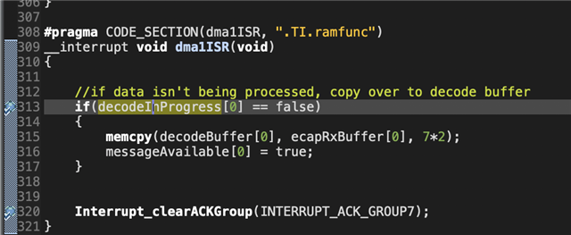

I've noticed lately breakpoints behaving strangely.
OSX 10.15.7
CCS 12.1.0.00007
Part F280049C
Let's look at this snippet:
As you can see I've set a few breakpoints, but the emulator never hits them.  However if I add a breakpoint on the memcpy, I immediately hit it.  I was also able to double click repeatedly on line 317 to add an infinite number of breakpoints to a single line:
I suspect my issue has something to do with the function being in RAM?

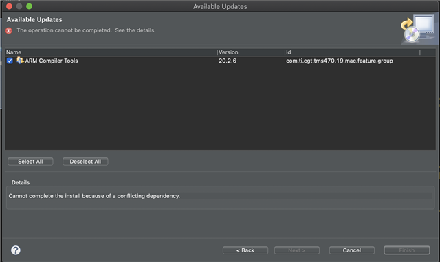

Looks like the updater is failing for me:

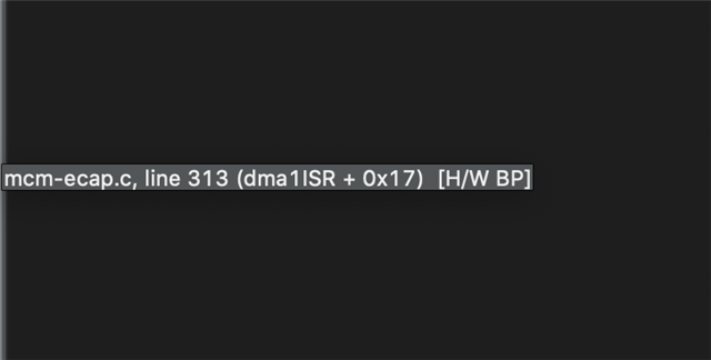

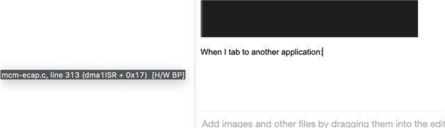

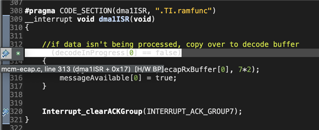

Also CCS has a tendencey to force its pop ups to the top of the screen.  This is specific in regard to the little breakpoint message that pops up. See below:
Debug View:
When I switch to edit:
When I tab to another application:
The behavior of this does appear to have gotten better.  Previously once this box was on screen the only way to get rid of it was to kill CCS.  Now it appears it will go away if you go back to debug view and mouse over the offending breakpoint.

  • Hi Trey,
    Do you build your program with optimization enabled? Would it be possible to provide a small reproducible test case

  • No I've got optimizations turned off.  I will try to put together a test case to send over.
    Like I said, no rush.  I know its holiday time.
