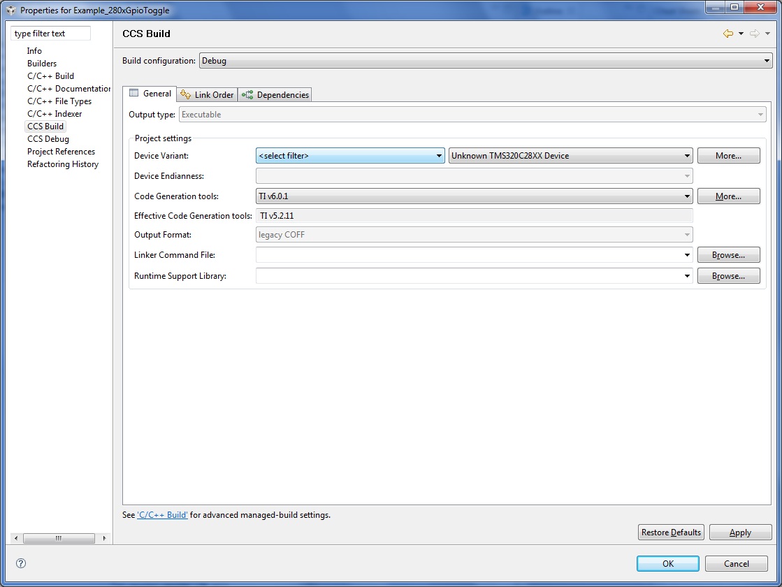

  • Hi Sean,
    one thing I did notice you should try is the working computers seem to have a newer version of the code generation tools.
    Please try using the latest version of the code generation tools (you may need to do an update Help -> Software updates -> find and install).
    First however go to Project -> Properties -> CCS Build and see if you have and can select C200 Code Generation Tools 6.0.1
    I have attached an image for you.
    Let us know.
    Cheers,
    Lisa

    Attached are screenshots showing what is described above.
    3513.screenshots-2011-11-04.zip
