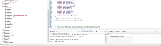

I am trying to debug a USB application and when I set a breakpoint I jump backwards to an incorrect line in the firmware application.  Does anyone know why this would happen?  I'm seeing sporadic behavior (jumping to what looks like random places) when using "step into" or "step over" at a break point.  An example can be found in the attached screenshot.  I try to "step into" the function call "USBDBulkInit" but instead jump backwards as shown by the arrow to "USBStackModeSet".  If I continue clicking jump into I eventually get into the function call where the breakpoint is set, but once in that call I just experience more sporadic behavior.

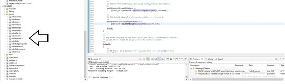

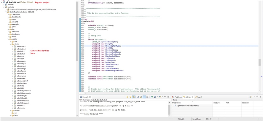

    1. When I open the usblib project to recompile after turning off optimizaitons I notice I'm unable to see the header files in the device folder.  Is this expected?  When it is "included" in my custom project and I go to includes folder and browse to this usb device folder in my CCS project navigator I can see the header files.

  • 1. When I open the usblib project to recompile after turning off optimizaitons I notice I'm unable to see the header files in the device folder.  Is this expected?  When it is "included" in my custom project and I go to includes folder and browse to this usb device folder in my CCS project navigator I can see the header files.
    I assume you are referring to usblib from TivaWare. The "Includes" folder in Project Explorer should show all the include search paths in the project build settings. If you expand the folders, it would list all the contents for the folder. The below is the expected behavior.

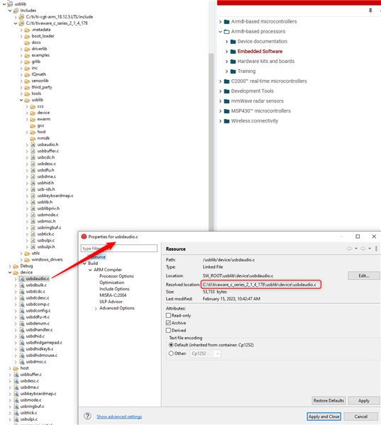

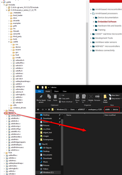

    My first question was really just asking why does my usb device test project (normal TM4C project) show the header files and the usblib (you are correct - from Tivaware) only show the .c files?  See screenshots below.  I figure I'm missing something when you import a library like Tivaware usblib.

    Because in your first screenshot, the Includes folder is showing the contents of all files in the directory.
    In your second screenshot, you are not looking inside the Includes folder but instead the <PROJECT FOLDER>/device. That folder is empty. In Project Explorer you can see a bunch of LINKED FILES. Those files are not physically inside that folder but instead the project has references to the actual location outside the project folder.
    You can see that by looking at the file properties that it is in the root TivaWare directory and not the project folder.
    Only the *.c files are linked, not the header files.
