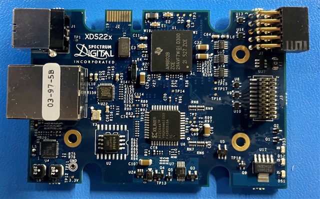

I have an XDS220 (PN 516300-0001, serial X2D_1401037) that I managed to brick by trying to perform a firmware update on OSX. Same symptoms as shown in this thread, but I can't seem to get CCS (on Linux or Windows) to connect to it with an XDS100v2. I have connected (and verified) TDI, TDO, TMS, TCK, RTCK, TRST, GND and 3.3V, but when I test the connection with CCS, it says there's a far-end break detected. If I use OpenOCD it actually connects and I can stop/step/etc. the processor, but loading the fw1009.bin to location 0x80010000 and trying to resume execution at the same address doesn't appear to work.
By "doesn't appear to work" what I mean is that the processor seems to run, but I don't see the USB device appear and if I halt the processor, it seems to be at the same endless loop instruction that it was at when I first connected. I’ve also played with TCK clock speeds, using RTCK or ignoring it… nothing seems to help.

I have also tried manually setting PC and SP to 0x80010018 and 0x40000000 respectively and resuming that way, but with the same results.
I'm quite sure I could recover this if I could only get the AM1802 to execute the code I've loaded. I have two questions:
1) How do I troubleshoot/resolve the "SC_ERR_CTL_CBL_BREAK_FAR" (-183) error in CCS? There isn't much info online and what is there is generic. I know the connections are good because OpenOCD can talk to the device.
2) What am I missing which is preventing me from getting the AM1082 from doing what I need via OpenOCD?

  • My apologies for not being clearer.
    It is the XDS220 which is bricked. The XDS220 uses an AM1802 internally. It is the internal debug interface on the card edge that I have connected to an XDS100v2. I am trying to use the XDS100v2 to unbrick the XDS220 through the XDS220's internal card edge debug interface.
    CCS complains that there's a "far end cable break" when I click the test button, but I have verified and re-verified the wiring between the XDS100v2 and the card edge debug connector inside the XDS220 and I can see no break. I have TDI, TDO, TMS, TCK, RTCK, TRST, GND and 3.3V wired up, as per the original (closed, locked) thread, tried different JTAG clock frequencies (100kHz all the way up to 10MHz including the default "adaptive up to 1MHz"), but the issue persists.
    If I close CCS and instead use OpenOCD to access the XDS100v2 I can connect to the XDS220's internal AM1802 just fine. I can see registers, dump memory, control code execution using OpenOCD. If I load the v1009 binary firmware image into 0x80010000 I can see the loaded image data, and I can use "resume 0x80010000" or set IP/SR to 0x80010000/0x40000000 and try to resume, but I cannot see the XDS220 show up on the USB port of the computer, which is what the video in the original, locked thread shows.
    I believe I'm missing something which is preventing CCS from being able to verify the XDS100v2's connection to the XDS220, but the information on what this specific error means is vague and is basically "check wiring" which I've done (and redone, and redone). OpenOCD seems to have no issue so I am confident that the electrical wiring is sound. My best guess is that I am missing a step that CCS is doing behind the scenes. Uploading the firmware, issuing a hardware reset, setting IP to 0x8001000 and telling the XDS220's AM1802 processor to resume doesn't seem to be enough which is why I'm asking here.
    Is there any specific additional step I must to to make the AM1802 internal to the XDS220 execute the firmware I've loaded into RAM? Some ICEPICK or CPU state I'm unaware of?
    Failing that, how can I get more information about WHY CCS is unhappy with the connection? As mentioned, I'm quite certain that the electrical connection between the XDS100v2 and the XDS220 is sound, because OpenOCD is having no trouble talking to the ARM9. I can run the `dbgjtag` command manually and if I don't include the `-S integrity` option, it completes without error:

    The final thing that I was unaware of is that the XDS220 I have is perhaps an iso after all, despite not being clearly marked as such. This is perhaps why the update script failed originally.
    For posterity, here are the steps I used:
    1. connect XDS100v2 (or any other JTAG tool you want) to the internal edge connector. Samtec HSEC8-110-01-L-DV was the connector I used because I didn't want to solder to the board.
    2. TDI, TDO, TMS, TCK, RTCK, TRST, GND and 3.3V must be connected. Additionally, if you're using CCS, the "target disconnect" signal (pin 4 on the TI 14-pin debug connector) must be grounded or you'll get a "far end break" error.
    3. If using OpenOCD, you can use the Beaglebone target definition as it's also using an AM1802.
    4. Connect to the target, load the xds200_firmware_v1009.bin to RAM starting at 0x80010000. Note that this is the XDS200 file, not either the XDS220 or XDS220-ISO files. They will not work. You must use the XDS200 file.
    5. reset the ARM9, and either set PC to 0x80010000 or resume execution starting at 0x80010000. If everything went well, the XDS220 composite USB device will show up in your USB device list.
    6. use the xds2xx_conf program to update the firmware to the XDS220 or XDS220_ISO firmware.
    7. use the xds2xx_conf program to reboot the XDS220. This takes about a minute but the USB device should show up again after.
    8. use the xds2xx_conf program to program the CPLD file. This also takes a minute or so.
    9. use the xds2xx_conf program to reboot the XDS220 again. It should now be updated and working correctly.
    One other small note is that it looks like the xds2xx_conf utility likes to be run from the directory that the firmware files are in. Updating the firmware by specifying the full path worked fine, but programming the CPLD file gave an odd "file app_cpld.bin doesn't exist" error. I never specified that name, I specified the xds220_cpld_iso_v1009.xvsf file with the full path. Rebooting the XDS220 and running the script from the ~/ti/ccs1230/ccs/ccs_base/common/uscif/xds2xx directory cleared up the issue, but this is not intuitive.
    My specific interconnection between the edge connector on the XDS220 and the TI 14 pin connector on the XDS100v2 is as follows:
    Signal Name
    XDS220 Edge
    XDS100v2 Header
    TRST 1 2
    TMS 3 1
    TDI 5 3
    TDO 7 7
    GND 11 8,10,12
    RTCK 13 9
    TCK 15 11
    3.3V 14 5
    TDIS - 4 (connect to ground)
    xds220 top side internal photo
