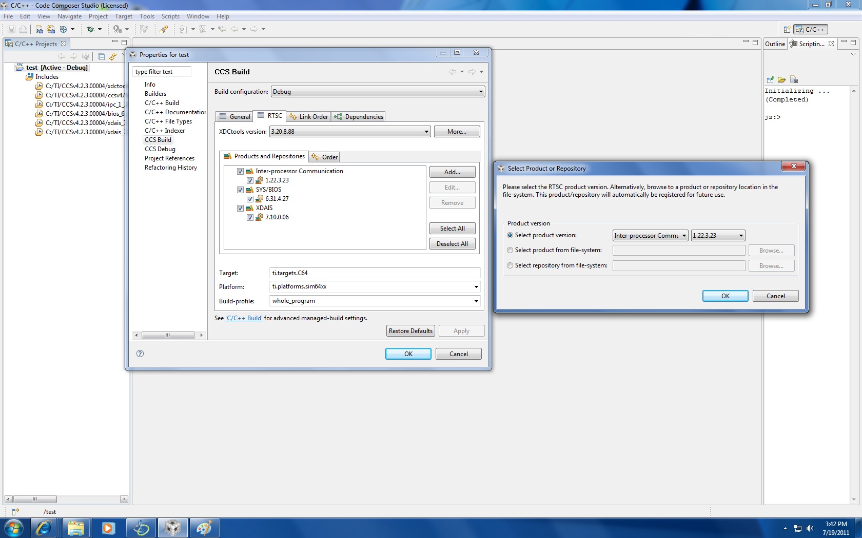

I have a lot of problems with different versions of BIOS/DSP and XDC. How can I change paths for each project?

    I think that the paths in brown color are incorrect (XDC configuration, I need xdc_2_95_02), but I ddon't know where I need change (xdcpaths?,environment variables?, some specific file in the project like .cfg??)

    Assuming you enabled RTSC support when creating your project, you can manage the version and paths etc as shown in the attached screenshot.  Project -> CCS Build -> RTSC.
    I hope this helps!
    Cheers,
    Lisa
  • Thanks for your response.
    My problem was with CCS3.3 after CCS4.2 installation. I'll try your recommendation with CCS3.3. I'll post the results...
