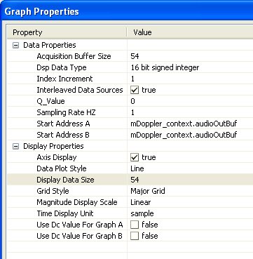

Hi Folks
C6472, CCSv4.2.4
I had several "Single Time" plots active but when I started a Dual Time it gives me an error message

I tried closing the dual time and opening another dual time. Same problem.
I tried different addresses. Same problem.
After I rebooted CCS, I started a Dual time plot and it worked fine with the same address.
Maybe the problem was having to many plots active.
Weird.

  • Hi
    It happened again. This time I only had the Image analyzer opened when I opened the dual time. So the issue can't be having too many single time graphs open.
    I restarted CCS, used the same address in dual plot, and its fine now.
    If it helps, the boxes I am changing are below (I've also tried using absolute addresses like 0xE000000 when it fails and the problem is still present)
