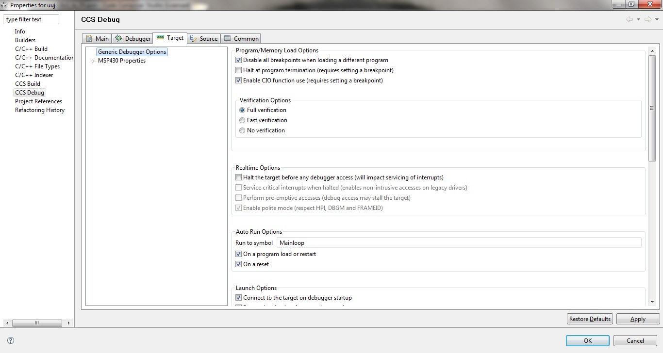

I am using the msp430F2619 device which is mounted in a socket on a MSP-FET430U64 board.

I selected Debug and it executed. The gray FET Debug module lights a RED LED at MODE, and the console section of the screen shows:
AutoRun: Target not run as the symbol "main" is not defined.
What does this mean? I can understand leaving something out if I wrote new code myself, but I merely added the example source code per instruction step3.

  • Hi Elvin,
    This does not surprise me and I see the same thing as the code is assembly.
    It simply means that it was trying to autorun starting from main.  In an assembly project there is no main ... it is Mainloop instead.
    You can get the target to do the same as with a normal C project by replacing run to "main" with run to "Mainloop" ,,,, see the screenshot of the debug settings.

  • How do I get to this screen from where I am in debug?
  • Hi Elvin,
    That screenshot came simply from Project -> Properties.   It should be clear from the picture from there which tab(s) etc.  If you still need assistance just let me know.

  • I thought that I replied to this last week but got not  further response. I waited until 1:30 and was not contacted.
    FYI at the point where I get the debug error about not finding "main" I am not able to select "properties" from the drop down menu, so I cannot access the screen that you show.
    How should I proceed?
