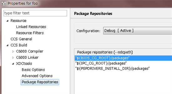

I'm trying to use CCS v5.1.0.06000.
When building my project some errors occured, and the cause seem to be associated with path setting.
In project's properties, there are following definition.
I want to confirm the contents of  "BIOS_CG_ROOT", "IPC_CG_ROOT" and "PSPDRIVER_INSTALL_DIR".
Where can i find the definition ?
  • Hi, in the Properties window, on the bottom of the window, there should be a "Show advanced settings" link, click that.
    Then you should see "C/C++ Build" category
    If you navigate to
    C/C++ Build -> Build Variables
    then click "Show system variables"
    You should see BIOS and IPC among those.  This applies to packages that were "installed" on your system. Other packages can often be found in the "C/C++ General->Paths and Symbols" subwindow, but BIOS and IPC are likely to appear in the 1st method and not the Paths and Symbols window.
