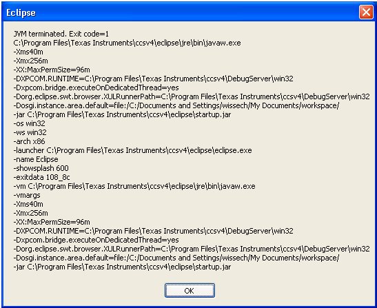

CCS4.2 Crashes during startup after installing ClearCase
# An unexpected error has been detected by HotSpot Virtual Machine:
#  EXCEPTION_ACCESS_VIOLATION (0xc0000005) at pc=0x781b606f, pid=4276, tid=3716
# Java VM: Java HotSpot(TM) Client VM (1.5.0_14-b03 mixed mode)
# Problematic frame:
# C  [urlmon.dll+0x8606f]
---------------  T H R E A D  ---------------
Current thread (0x04bbfe50):  JavaThread "Worker-0" [_thread_in_native, id=3716]
siginfo: ExceptionCode=0xc0000005, reading address 0x00000000

After installing ClearCase, when I try to start CCS v4.2.4, The Eclipse environment comes up for several seconds.  Then an Eclipes error window pops up and the Eclipse environment closes.
I tried this on a second computer installing ClearCase then CCS with the same outcome.
A CCE 3.1 installation works.

  • There is a fix for the problem.
    1. Rename the C:\Program Files\Rational\Common\java to something like _java
    If you have a C:\Program Files\Rational\Common\java142_07 directory rename it as well to soemthing like _java142_07
    2. Launch code composer as normal
    3. After launching code composer you'll undoubtedly get a IBM.. popup dialogs-> hit cancel (this pop-up will happen several times)
    4. Select window->preferences
    5. In the preferences dialog select install/updates
    6. Modify the proxy settings to have "manual proxy configuration". Set the HTTP Proxy & HTTPS proxy settings for you network
    7. Click apply
    8. Shut down code composer
    9. Rename the folder(s) in step #1 above back to the original names (ie C:\Program Files\Rational\Common\java)
    This has been done on a couple of machines now and it appears to work.
  • Thanks Danimal!!
    That seems to have done the trick.
    I owe you an EtherBeer!
