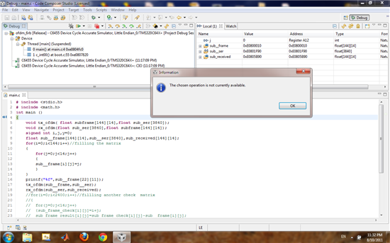

when i try tools--> profile in ccs4 after i launch the debug , a new window comes up on the screen "the chosen operation is not currently available"
any help ?

Profiling is supported on your target. Could you provide a screenshot of the CCS environment when the error occurs? I'm tying to determine when exactly the error occurs.
after i launched the debug session, the simulator is waiting to run ,when i try to profile then i get the following message "the chosen operation is not currently available" which appears in the screenshot ..
thanks .......

Sorry for the delayed response. I don't seem to be able to reproduce this. What is the full version number of your CCSv4 installation? If you have not updated to the latest 4.2.4 update, I suggest you take that first and try again. If that fails to help, try the steps in the troubleshooting guide (new workspace, delete cache files, etc):
http://processors.wiki.ti.com/index.php/Troubleshooting_CCS

the reference link you posted helped me, i cleaned the .metadata folder from my workspace and re imported my projects again resolved the issue, now the profile error message is gone...
