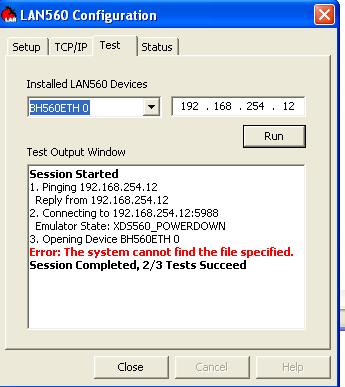

    Also on machine A (CCS 5.3 under win XP SP3) when I run the bhethcfg.exe file (under program files\blackhawk\Emulation\drivers\LAN\v2.0.0.4) I get the enclosed message:
          Error: The system cannot find the file specified.
    I assume that the utility can find the .dat file created by CCS.
    Is there something to do to point it to the file?
    Thanks and best regards,
    Anthony

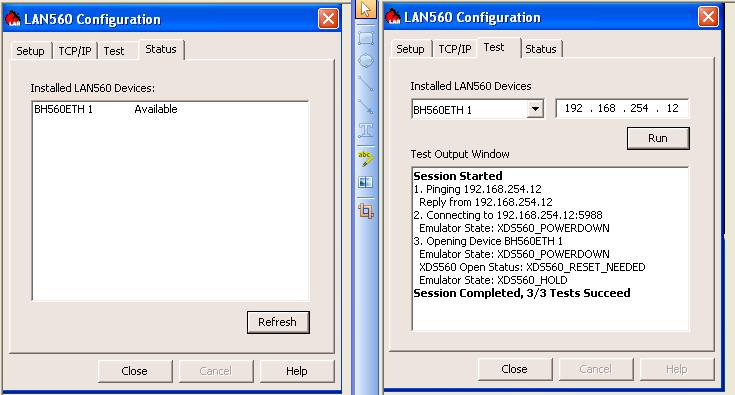

  • Ok, now I get the same log from the LAN560 from both PC (see enclosed).
    However from the CCS side (test connection) I still get the same error message.
    Am I missing something in the CCS config?

  • Hello Anthony,
    From the images provided, you have the LAN560 with IP Address 192.168.254.12 configured at "BH560ETH 1".  This coresponds to I/O PORT #1.
    Do you have CCS configured to use I/O Port #1?
    You'll need to switch to the adavanced tab within the Target Configuration dialog and select the emulator connection.  Then you can view/change the Emulator I/O Port Number.  The default is 0.
     -Andrew
  • Hi Andrew,
    You are correct I just had to specify the port and not the ipaddr.
    In fact I used CCSv5.3 under Linux last week and I did not realized that in advanced config the ipaddr field in CCS for Linux was different from the I/O port number Number in CCS for windows.
    I am just wondering where the IP address is taken from since it does not appear in the .dat file.
    Thanks for your help.
    Anthony
  • Anthony,
    Under Windows, we are still limited by the original Windows Kernel mode driver of the TI XDS560 porting kit.  We must supply a kernel mode driver, which has no access to or knowledge of  the DAT file information.  Without getting too specific, we have to propagate the kernel mode stuff back to user mode to get access to the computers Ethernet connection.  This "re-director" for the LAN560 accesses the IP address stored by the bhethcfg utility based on the I/O Port number.
    There are less restrictions for Lunix and we can use the actual IP address in CCS.
    Andrew
