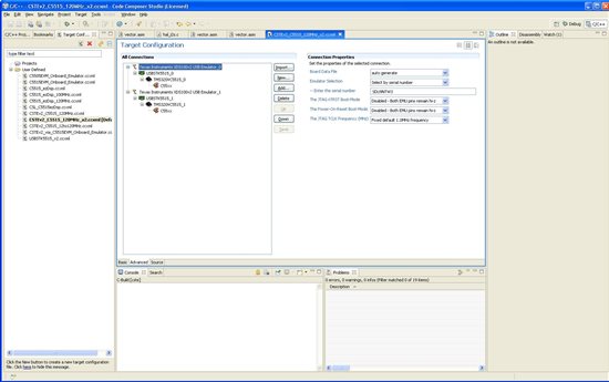

I'm using two separat target boards the C5515 USB Stick and my custom board with a processor with an XDS100v2 board JTAG connection.
I'm wanting to download and debug code to one board while simultaneously debugging with another board all within the same code composer workspace. version 4.2.3.00004

I open the device manager and notice that both emulators are listed.TI XDS100 Channel A, TI XDS100 Channel A, TI XDS100 Channel B, TI XDS100 Channel B
I open code composer to my workspace.I right click on my project and select  "Debug Properties". I click "Prompt to select CPU". I then try to debug active project and don't get a dialog requesting which CPU to connect . I go back and change the debug properties to "Connect to exact CPU"  and the drop-down list only shows 1 CPU and emulator.
How do I show both target boards?

 I can download and debug with each board independently with only a single USB connection present to the relative board. However, I cannot have both boards plugged in at the same time and debug to both boards simultaneously.
