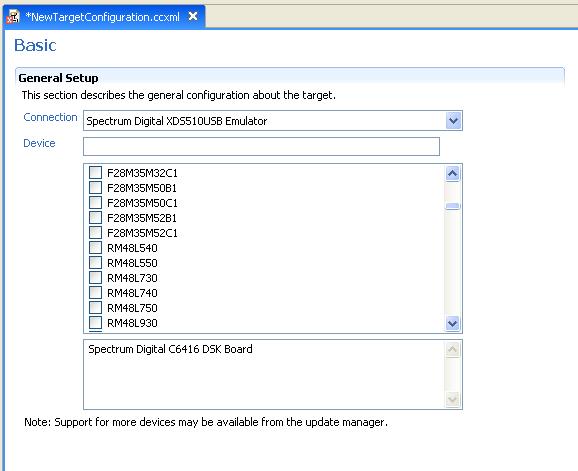

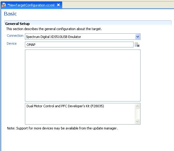

I'm not able to create a new target configuration with the Spectrum Digital XDS510USB emulator for the OMAP-L138 component : the component doesn't appear in the list.
Why ?

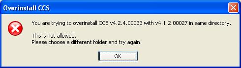

If you re-run the same installer on top of your existing install directory, you can add/remove components. You should also be able to determine what components are installed.
This is not possible because I made updates.
See the image below.
How can I do ?
It sounds like those components didn't get installed. You'll have to reinstall CCS. Sorry.
