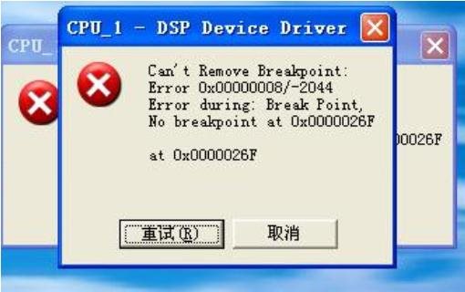

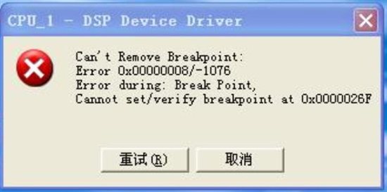

hi,friend,
the following is the descriptions of my problems:
platform
  TMS320LF2407A  target board.                      ccs3.3
The targer board is one that I myself made,not EVM.            I used my target board to control permanent magnetism synchronous motor (P.M.S.M.)open-loop sucessfully.    However,when I have another close-loop routine run on my target board,a problem occors.     Both building and loading are right.     I set a breakpoint in  a specific line and hoped the CPU halt when it encountered the breakpoint.      Unexpectedly, the CPU don't halt.  It  keeps running. It seems that the  breakpoint is ignored.  The following information comes up when I disconnect CCS with DSP.
Trouble Removing Breakpoint with the Action "Halt Target" at 0x2ae: Error 0x00000008/-1076 Error during: Break Point,  Cannot set/verify breakpoint at 0x000002AE   Sequence ID: 8 Error Code: -1076 Error Class: 0x00000008
Failed to remove the debug state from the target before disconnecting.  There may still be breakpoint opcodes embedded in program memory.  It is recommended that you reset the emulator before you connect and reload your program before you continue debugging.
I am a freshman in the DSP field.  May you give me a solution, please? Thanks for your attention in advance.

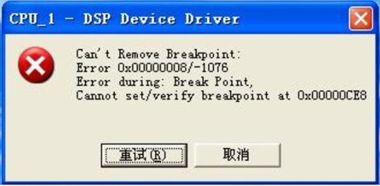

        Several days ago,I used CCS 2000 version 2.21. Except those error messages mentioned last letter, there are some error message boxes coming forth as the followings after the CCS is shut down. What could we draw from these message boxes?

    Setting a breakpoint in an ISR is perfectly legal, but I just recalled something: are you disabling interrupts when you enter your ISR code? Better still, are you setting the breakpoints after the interrupts are disabled?
    I am not very familiar with the C2400 family, but interrupt nesting is usually a non-desirable condition: this nesting may never happen during normal execution, but if the processor is halted during the execution of an ISR, it gives time for the other peripherals to interrupt or queue its interrupt requests.
    The linker command files seem ok to me - from what I see I can't think they are causing this. For additional linker command files, check the LF2407 examples code at:
    http://focus.ti.com/docs/toolsw/folders/print/apslf240x.html
    With regards to the error messages, the only thing I can imagine is that both CCSv2.1 and CCSv3.3 are showing very similar errors. This reinforces the idea the emulator is losing control of the device and CCS can't properly reset the device debug status (including any associated breakpoints).
    Because CCSv2.x does not have a "disconnect" feature as CCSv3.3, the error message manifests itself when the software is shut down - the phase where CCS is also resetting the debug status.
    Unfortunately I really can't pinpoint an exact reason to why this is happening, but I will let you know if I find something or have additional ideas, ok?
    Rafael
