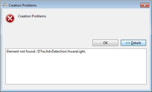

I am used to import my projects with a macros.ini file for getting projects with relative paths. But strangely, I am now getting an error message I have never encountered before. Here are my setup:
- I have a project with a macros.ini file defining the path variable SRC_ROOT.
- The project contains several linked files and folders
- The linked files and folders are not under the project root folder
- The project root folder is not inside the workspace root folder
- My workspace already has a path variable SRC_ROOT defined with the correct path (because other projects use this same variable).
If I import my project with the "Project -> Import existing CCS... project", I get the following error window:
The project looks being imported anyway in the workspace, but any linked folder/files does not appear.
On the other hand, if I first delete the path variable SRC_ROOT in the workspace and repeat exactly the same procedure, the project is successfully imported with no error message.
Is there something I am doing wrong or is this a bug with the import feature?
Franck
  • Missing the error message image in my original post. Here it is:
  • hi,
    I faced same issue .
    Are you using ccsv4.2? Sometimes  I need to click on File -> Import -> Code composer Studio -> Managed Build Macro and select the macro.ini file.
    You need to overwrite the value if already existing.
    I thought it was better in ccsv5.1, but sometime  Istill need to do this.
    And if it still not ok, you can close and reopen the project
    rgds
    Yes I am using CCS v4.2.4. The steps you suggest actually appears to be another valid workaround for this issue.
    So I understand that this is a known issue/limitation for the import feature of CCS that is not caused by any specific misuse? If so, I will just apply the workaround when the problem shows up.
