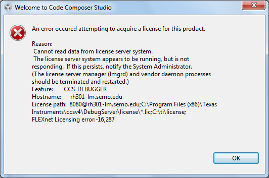

I have run into problems activating CCS 4.0 floating license. A license server has been configured by our IT professionals, and I can see all the licensing processes running. However, on the workstation, when I start CCS, it says that the software is unlicensed. I then click on "Licensing Options" under "Help" on the menu bar, and I receive the following error:
I have tried to restart the above mentioned lmgrd and vendor daemon processes several times, still the same error. Any idea? BTW, how to contact TI support on activation issues?

    Have you tried rereading the license file?  Have you verified the file is not corrupted?
    One thing you can try with this type of error is to make sure the path to the file is less than 32 characters.  Sometimes a long path to the license file can generate this particular error.  Can you please try this?
    The following two posts may have one or two other quick things to try with this flexnet error.

    Mr. Blankenship spent a lot of time on this. He re-installed everything, and we found out the problem. Apparently CCS4 does NOT support Win7 64-bit Enterprise edition. I will contact TI University Program and see how I can get the new edition. Does CCS 5 support Win7 64-bit?

    Actually I have a Windows 7 64 bit machine myself (not sure if enterprise version) and successfully run both 4.2.4 and 5.1 versions of CCS.   So you should not be seeing any issues.  One item one must be careful with is of course permissions.   Windows 7 is very strict with permissions and so one needs to be an administrator for most things.
