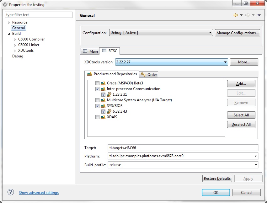

    Hi Bernd,
    Can I ask you for a bit further information.
    1 - under Project->Properties->General->RTSC ... what do you have selected as your platform?
    2 - in your ccxml file, which simulator have you chosen?
    I have tried the stairstep example in CCS 5.1 without issue.  Could you also see if 5.1 works/behaves differently for you.
    Attached are screenshots of my working configuration.
    Lisa
  • Hello Lisa,
    first to the configuration:
    1. The selected platform is not the core, but the ti.platforms.evm6678 (but also tested with the core)
    2. The simulator is the same as yours
    I've tested it again in CCS 5.0.3 with the core as platform, but there's no change. But with CCS 5.1 you're right, the application is working very fine. So it seemes there's a bug fixed in the new CCS. So for the simulation I can work with CCS 5.1. Have you tried the example in CCS 5.0.3? Does it work?
    Thanks for your help,
    Bernd

    System.maxAtexitHandlers = 4;
    BIOS.heapSize = 0x2000;
    Program.stack = 0x1000;
    SysMin.bufSize = 0x400;
    System.SupportProxy = SysMin;
    // Configure a Timer to interrupt every 1s
    var timerParams = new Timer.Params();
    timerParams.startMode = Timer.StartMode_AUTO;
    timerParams.period = 1000000;        /* 1000000 uSecs = 1s */
    var timer0 = Timer.create(Timer.ANY, '&timerFunc', timerParams);
    Bernd

    unfortunately I don't have 5.0.3 installed currently so I will have to see if I can find the time to install and try it.   To be honest it is strongly recommended to use the latest version anyhow so I am happy to see you report that 5.1 functions much better for you.   And yes, there are a couple known issues with 5.0.3.
    Regarding the new enquiry.  Which examples (unmodified of course) are giving such errors?  I know we did find a couple things with some of the C6x family examples so it is possibly a know item.
    I took a brief look at the two code snippets you sent.  One thing I noticed is that you do not seem to include the hwi and csl files.  (ie hwi.h)   Make sure to include all necessary files.
    There is some further useful information for you below and in the attached file.
    Please keep me informed.
    Lisa

  • Hello Lisa,
    first of all thanks for your help and documents. I think there is some missunderstanding: I test everything in CCS 5.1, so you don't have to install or test something in CCS 5.0.3. Just to order all the stuff, I'll try to give you concrete questions. My final aim is to get a simple application which uses a timer/clock.
    1) I've testet the Static-example. Problem is, that it doesn't finish and no printf can be seen. Debugging the example, the program always runs through the Idle_loop (and therefore the method Idle_run() in the Idle.c) and the SWI and Clock never seems to be called. Every breakpoint set in this functions is never reached.
    2) To test the timer module, I've just added a simple timer to the Static-example via SYS/BIOS and change the timer0Fxn to this:
    Void timer0Fxn()
        System_printf("Running timer0Fxn\n");
        finishFlag = TRUE;
    The configuration source also looks okay:
    var timer0Params = new Timer.Params();
    timer0Params.instance.name = "timer0";
    timer0Params.period = 1000000;
    Program.global.timer0 = Timer.create(Timer.ANY, '&timer0Fxn', timer0Params);
    Compiling and running the example with this few changes making CCS to terminate unexpected with an java.nio.channels.ClosedByInterruptException.
    3) I've tested the Stairstep example, also after new creation of the project. Here also CCS terminates unexpected with the java.nio.channels.ClosedByInterruptException.
    So my aim is to run the Static / Stairstep example without crashes and maybe with modifications so that a timer can be used.
    Your advice for RTDX should not be relevant for me because this is only necessary for DSP/BIOS and not for SYS/BIOS, am I right? To this topic, I also have a question: are there any (dis-) advantages or differences to use DSP/BIOS or SYS/BIOS? I've decided to use SYS/BIOS due to more examples and more functionality, but I'm not sure what's the main difference between these two packages.
    Bernd
