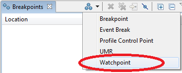

memory address breakpoint
when I run my program I get the following
TMS320C64X+_0: Warning: C674x_or_EDMA: READ access - 0xe38def3c
while, it is nice of the simulator to tell me, it is almost useless if I cannot trap the error somewhere.
is there any place in the debugger where I can set a break on a memory access?  or even break on a warning from the simulator?
    You can set a watchpoint to break on a memory access.
    ki
  • I have been setting various watchpoints.  As far as I can tell the app should break when it hits one of those points.  But it never breaks.  This despite messages from the simulator that the address in the watchpoint has been read or written. Any idea why this is not working for me?
