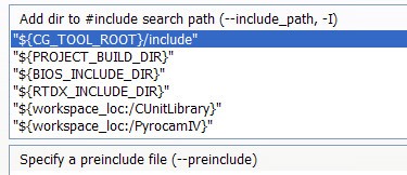

    I have attached two screen shots showing examples of where some of these paths are set.  You can also right click on a file in the project directory to see where CCS is looking for it.

    ok.   information that might be useful for us are things to do with the linking etc.  For example are you using relative or absolute paths?  How did you import/link your files into the project?  Where is the project looking for the files (right-clicking on a file and properties) also the general file paths you have set up as per the screenshots a few posts ago.  That information would help.
