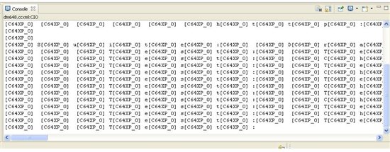

When running debug on target the string [C64XP_0] is written after every output character (see image below). This renders the console output rather useless. Is this the result of some option in CCSv5? The same SW/HW/configuration/project setup worked fine in CCSv4 with correct output.
I'm currently working with a Blackhawk XDS560v2 System Trace emulator towards a DaVinci DSP in CCSv5 version 5.0.1.201105110900
  • In v5.x all the output goes to a single console by default so CCS inserts the CPU-core name in front so that you can tell which core it is coming from.  For your example is each character being sent by a separate printf?

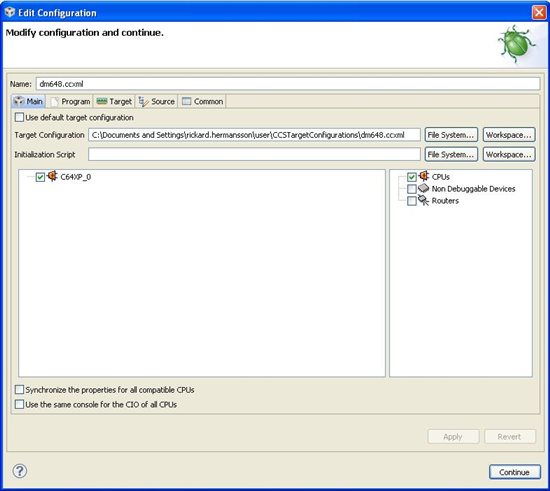

  • Looks like there is an option to control this.  By default all cores use the same console but you can change that.  To change the setting right click on your debug session and select "Edit <session>" where session will either be the name of the project being debugged or if it is a projectless debug session it will be the ccxml file name.  You can the uncheck the option to use the same console for all cores.
  • I'm using a single core so there is no need to print which one the output is from. I tried to uncheck the box in my config but the output didn't change.
    This is my ccxml config:

    Try terminating your debug session and launching again to make sure the setting gets applied.  Note that in 5.1 if it is a single core device you won't have to do this.
    John
  • Works like charm after restart!
    Still I don't see why I need to disable the option. It is a single core device but maybe I have some faulty configuration? (see printscreen in earlier post)
    Thank you!

    This also solved my problem.  I would never have thought to right click on the .ccxml file either.  The default CCS behavior was making assert() statements much more difficult to read.  Instead of  "Assertion failed ..." you'd get "[C64+_0]A [C64+_0]s [C64+_0]s [C64+_0]e [C64+_0]r [C64+_0]t [C64+_0]i [C64+_0]o [C64+_0]n [C64+_0] [C64+_0]f [C64+_0]a [C64+_0]i [C64+_0]l [C64+_0]e [C64+_0]d ...".  As you can imagine, that makes it a little difficult to see *which* assertion failed. (To work around it, I'd cut/paste into Notepad, and search/replace all the [C64+_0] tags out.  It works, but it gets old quick.  I guess that's incentive to make fewer bugs and throw fewer assertions, eh? ;-) )
    Is it possible to improve CCS's default behavior here for the shared console case?  The current CCS behavior adds that tag in the shared CIO console whenever a given CPU flushes its CIO buffer.  (For stderr, that's after every character.)  Should it instead only output that tag in the shared CIO console when switching between CPUs?  That way if the same CPU is outputting a bunch of stuff, you get the [C64+_x] tag only once, and then if another CPU outputs a CIO message, you get one tag for that, etc...
    --Joe
