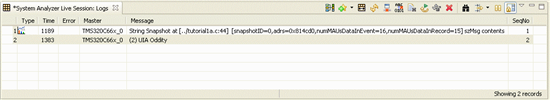

Unless I use a constant string literal, the Log_printx() will only display "<String @[its address]>" instead of the actual string even though a string is a supported format specifier (%s).  Is this a bug, or am I just doing something wrong?  (See screen shot below.)
Oh, and in case it is suggested, in my original code, my char buffer was a global variable, not a stack variable, but I still got the same "<String @blah blah>" results.  Also, it's not an implicit casting issue.  My original code is casting it as "(IArg)((const char*) &szMsg[0])" but for screen shot purposes and width restrictions, I removed the cast since I get the same results anyway.

         In order to display the text associated with a dynamically allocated string, System Analyzer needs to have the string's memory content uploaded in a separate 'snapshot' event.   Here's how to do this:
    1.  in your .cfg file, add the following line so that your program can use the ti.uia.runtime.LogSnapshot module:
    var LogSnapshot = xdc.useModule('ti.uia.runtime.LogSnapshot');
    2.  at the top of your .c file, add
    #include <ti/uia/runtime/LogSnapshot.h>
    #include <string.h>   // for the strlen API
    3.  add the following line of code after the string has been initialized but before it has been logged with the Log_print1 API:
    LogSnapshot_writeString(0,"szMsg contents",szMsg, strlen(szMsg));
    Here's the resulting System Analyzer output in the Log View:
    My apologies for the poor documentation on this topic.  I'll update the CDoc documentation for the LogSnapshot module in UIA to better describe how to use the API, and will also post a tutorial on the System Analyzer Wiki showing how to use the API.
    I hope this helps.  Thanks for your interest and feedback!
      Brian

  • So I finally got around to trying what you suggested (I assumed it would work, hence was in no hurry to test it out), and I am still getting a "String @<address>" rather than the actual string.
    I even wrote a dummy function to mimic exactly the sample funtion you have in the help file (in the LogSnapshot_writeString() section).
    Passing a string to that function just yields the following output (I'm just citing the "Message" column here):
    "String Snapshot at [../UIA_Test.cpp:131]  [snapshotID=0,adrs=0x1081ab40,numMAUsDataInEvent=68,numMAUsDataInRecord=67] User-defined name=<String @72616f42>."
    If I step through the code up to the LogSnapshot_writeString() call, the string I am using is valid--it's just does not seem to get sent to CCS.
    Long story short, be it via Log_printx() or LogSnapshot_writeString(), the string pointer used for "%s" has to be stored in the .const section, i.e., a string literal, or it won't get copied and sent.

     In the current release, you need to follow the call to LogSnapshot_writeString()  with a call to Log_printX in order to have the string decoded.  Here's the full example code:
            char szMsg[256];
            sprintf(szMsg,"%s","(2) UIA Oddity\n");
            Log_print1(Diags_USER1,"%s",(IArg)szMsg);
    Once the string contents have been uploaded by the call to LogSnapshot_writeString, the host-side tooling is able to resolve the address that is referenced by the %s format specifier in an event,.  i.e. any call to e.g. Log_print1(Diags_USER1,"%s",(IArg)szMsg); that occurs after the LogSnapshot_writeString() event has been logged will be displayed with the dynamically allocated string contents shown as text instead of as the address of the string.
    I can see that, from a user's perspective, it would make a lot more sense to simply be able to upload the string and display it using the same event.   We'll try to make some changes in the way the host-side tooling decodes events to enable that in one of the upcoming System Analyzer releases.
