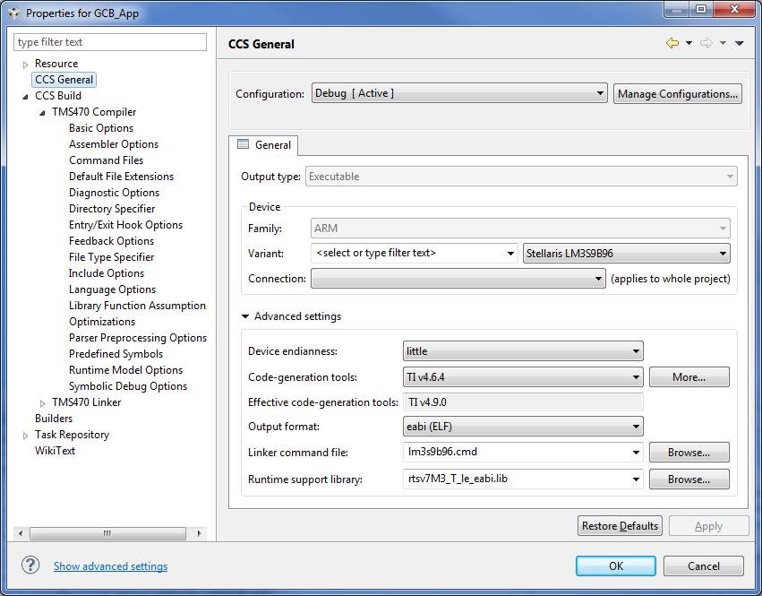

I have a project that I started with CCS4 and have since upgraded to CCS5.  The target is Stellaris based using a 9D96 CPU.  The debug build is fine but I have a problem with the release build.  When I go to project properties and look at the CCS general tab, the screen is properly displayed but if I switch to release Configuration, the screen is blank (see below).  I have printscreens of the screens I am describing.  I was looking at these screens because if I try to build the release, I get an error from, the compiler “This project was created for a device-variant that is not currently  recognized:….
I have two different Stellaris projects I have upgraded from CCS4 to CCS5 and one woks fine and the other has this problem.
I assume one of the project files is corrupt but I have not been able to figure out what one or how to fix it.

  • I went back to the version 4 project and verified I could see the the CCS Build options for both debug and release.  I then opend the project in version 5.1 and let CCS convert the project to a V5.1 project to re import the project into V5.1.  Using CCS V5.1 I then checked the CCS General tab to look at the target build configurtion and I have the problem I originally posted about.  It appears I can convert one of my two projects from v4 to v5.1 without any problems and the other project I can convert from v4 to v5 but only the debug build will work.

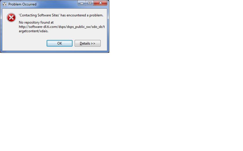

  • I know I can’t share the project because there are some legal issues but I could do a remote desktop some time if that would help.  When I try to update CCS 5.1 I get the error shown below:  How do you recommend I update CCS5?  I get this error by doing a help->check for updates.   Do I have to install a new version to get the latest?
    Doug
  • The update mechanism in CCSv5 isn't quite working right yet. We are working to address this before final release. In the meantime, you can download the latest build from http://processors.wiki.ti.com/index.php/Category:Code_Composer_Studio_v5#Downloads.
    You can uninstall your current version (make sure the install directory is completely deleted before reinstalling to the same location) and then install the latest build, or you can install it in a different folder and keep your current version.
