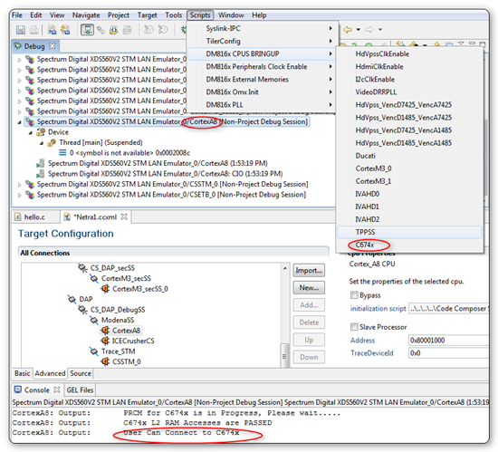

I'm having trouble connecting my spectrum digital XDS510 USB emulator to the 674x DSP on a C6A816x EVM board. I've setup a CCS4 target configuration based on the TI816x board and using an evm816x gel file obtained from the Spectrum Digital website.
I'm get the following error message when I try to connect to the target:
Error connecting to the target:
Error 0x80000240/-1180
Fatal Error during: Initialization, OCS,
The target is being held in reset.  The applied reset must be released before progressing.
Below is the heirarchy of Routers, subpaths, CPUs that is available under the target configuration. Which of these CPU should be in the scan path in order to perform DSP debugging?
TI816x
        IcePick_D_0
            dspSS --> C674X_0
            IVAHD0_iCont0 --> ARM9_0
            IVAHD0_iCont1 --> ARM9_1
            IVAHD1_iCont0 --> ARM9_2
            IVAHD1_iCont1 --> ARM9_3
            IVAHD2_iCont0 --> ARM9_4
            IVAHD2_iCont1 --> ARM9_5
            Ducati1 --> CS_DAP_RTOS -->CortexM3_RTOS -->CortexM3_RTOS_0
            Ducati2 --> CS_DAP_ISS -->CortexM3_ISS -->CortexM3_ISS_0
            secSS -->CS_DAP_secSS --> CortexM3_secSS --> CortexM3_secSS_0
            DAP -->CS_DAP_DebugSS --> ModenaSS -->CoretexA8
            DAP -->CS_DAP_DebugSS --> ModenaSS -->ICECrusherCS
            DAP -->CS_DAP_DebugSS --> Trace_STM --> CSSTM_0
            DAP -->CS_DAP_DebugSS --> Trace_STM --> CSETB_0
Any advice to help me bring this board up will be much appreciated.
