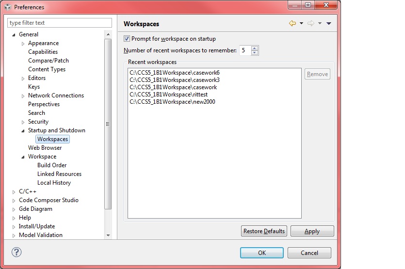

experimentation included creating numerous workspaces that I no longer want to see when I "Switch workspaces..." I have searched directories and registries with no luck.
where is the list of workspaces stored? (so that I can edit list)
The recent workspaces are stored in the <install dir>/ccsv5/eclipse/configuration/.settings/org.eclipse.ui.ide.prefs file.
