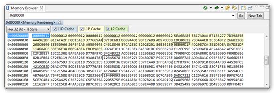

Enable memory Analysis in CCS4.2.3?
When doing a non-project debug session the "Enable Memory Analysis" button is greyed-out.  How do I enable this so that I may see exactly what is in cache and external memory?

  • Lee,
    This is for the C674x DSP core right?  The feature is not available for the A8.
    I tried this out in CCSv5.1 and it seems to be working fine on C6A8168.  It came up enabled by default, I didn't have to change any settings.
    I also tried CCSv4.2.4 and I see what you see, memory analysis is not available for me to enable it.  I know there was an issue where the C674x core was not being recognized as supporting cache accesses but I had thought that was resolved.  Looks like it is only resolved in 5.1.

  • Lee,
    I tried out a couple more emulators with CCSv5.1 M7 and the 8168 board and I am still able to connect and show cache analysis fine.
    Usually when there is a problem with setting a breakpoint there will be some sort of error message in the console view that provides more info.  Note that you can't set a breakpoint if the core is running.  If that is the case the breakpoint should show up but be disabled (no message is displayed in this case).
