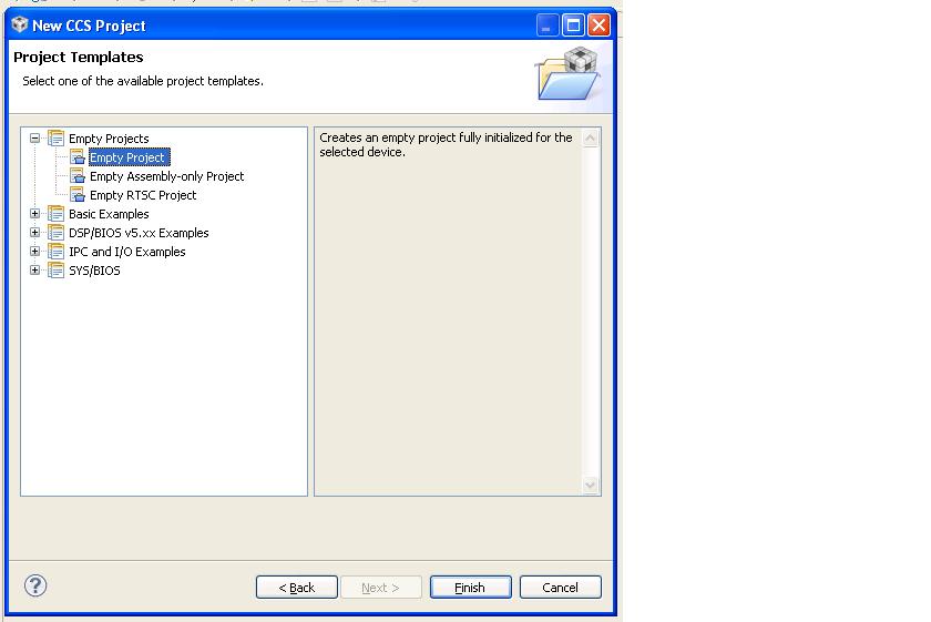

  • Lisa,
    I think we're getting somewhere. I have DSP/BIOS 5.x examples, but no SYS/BIOS examples:
    Could you track down what component should install them? I've put my installed component list below.
    Adrian

  • Hi Adrian,
    ok please check the following.
    1) See the below screenshot.  SYS/BIOS examples may be hiding from you at the bottom of the list.  It is actually normal to get both the old DSP/BIOS and the SYS/BIOS examples listed.  See the screenshot at the bottom of the post.
    2) After you check the above, if you can confirm that you really don't have SYS/BIOS installed (which should be the case ...) then you can find it here and try to install it that way.
    http://processors.wiki.ti.com/index.php/Category:SYSBIOS
    Once again please keep me updated.
    Lisa
  • Lisa,
    that's interesting - I don't have the SYS/BIOS examples, but I do have Multicore System Analyzer examples. I have two installation directories. CCS is installed in a working directory under my account:
    The MC SDK is installed under C:\Program Files(x86)\Texas Instruments:
    So I have two versions of SYS/BIOS installed, which matches the options in my earlier post.
    The bios_5_41_10_36 directory contains examples for many boards, but the two bios_6... directories only contain directories 28x, generic, and msp430 as examples:
    If there's an install package I've missed, could you point to it?
    Adrian
  • Hi Adrian,
    that is odd.   Are you sure if you minimize the examples SYS/BIOS examples are not at the bottom of the list?  The folders you have are fine and do not indicate a problem.
    Can you send me the equivalent screenshot (all examples shown) to mine below?  Is there anything that was done with the installations?  It is really odd that you have it as both part of CCS and independently installed but seem to have trouble ...
    Please let me know.
    Lisa
  • Lisa,
    Thanks for the help. I've now fixed the problem by moving to CCS v5.1 M8. The clock example is now available for my target board, and builds correctly. Unfortunately I can no longer build my plain CSL projects, as v5.1 interprets them as RTSC projects and produces the following error:
