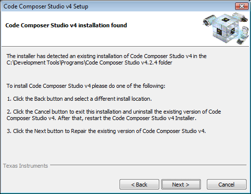

  • It should.  If it is working in CCSv4 it would be ok in CCSv5.  If you have one of those emulators I bet you have a full MCU license of CCS.  If you have a full MCU license then in v4 you can have a single install for C28x and MCU without any code size limit.
    You could try running the installer again for the version you have installed and specifying the same folder.  It will detect that there is an installation there and give you the option to repair it:
    It then will give you the option to add features.  It doesn't let you remove features but you can add them.  As for device support I am unsure if you can add support.  My installs all have all support installed so I can't see if it will let me add support for another family.

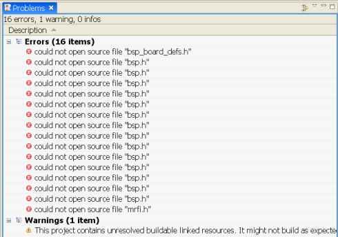

  • So in the meanwhile I downloaded and installed the CCV4 limited ver. in a new folder.
    So I was finally able to import "eZ430-RF2500 Wireless Sensor Monitor " successfully and compile but I get a ton of compilation errors:
    This is somewhat disappointing because "Out of the box" became a full wasted day so far. Will continue tomorrow.
    Danny
  • Danny,
    That is probably an issue with the way the include paths are setup in the example project.  Some example projects are setup better than others when it comes to portability.
    John
