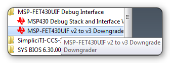

My USB FET will no longer work with M7 on Windows 7, or MSP430_Flasher on WinXP after receiving a firmware upgrade from M8.  It will still work with M8 on Windows XP, but it will not even pass enumeration on Windows 7--it generates 3 monotonic notes (I'm not sure what that means).

  • There should be a utility on your Windows start menu after installing M8 that ill allow you to downgrade your firmware.

    M8 and the downgrade utility were the only apps able to see the FET.
    I ran the downgrade utility and then checked the firmware version with FETPro--it indicated that the firmware was newer than the newest available, so I rolled it back.
    Now it works with CCS M7 again!
