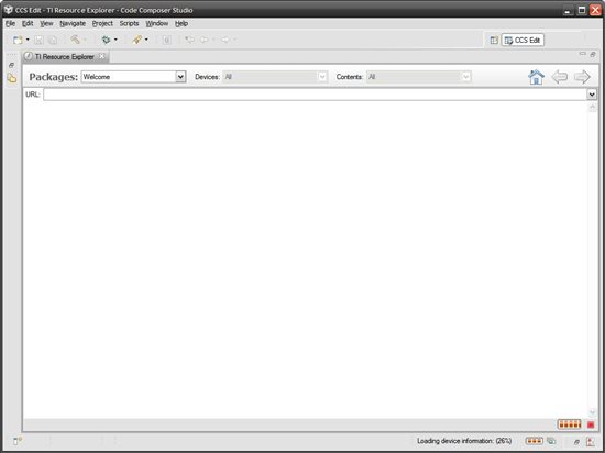

CCS v5.1.0.07001 is crashing on me when I try to open and select a new workspace. The steps I go through:
1. Splash screen comes up. I select a new workspace
2. The CCS Edit view comes up
3. TI Resource Explorer opens up in the IDE automatically. While this is initializing the view the CCS window just disappears. There are no error dialogs at all. I've attached a screenshot of what it looks like right before crashing.
I noticed that if I can close the TI Resource Explorer before it crashes everything works ok. CCS can be closed and re-opened using this workspace without any problems. I can also re-open the TI Resource Explorer in this workspace and it does not crash.
This problems happens every time I create a new workspace. Let me know if any more information is needed.
I'm running Windows XP SP 3
Mike
