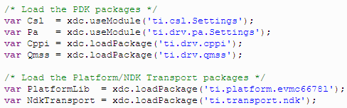

    Sorry for the delay.  I checked with the Low Level Driver (LLD) team that owns the various components.   The official answer is that you need to pull in the LLD packages in order to use the NDK.    i.e.
     You technically don't have to include the PA package, but if you don't you would then have to interface the queues to the switch yourself.
    The NDK/NIMU also requires application to provide resource manager and OSAL implementation.   Information on RM and OSAL is available at http://processors.wiki.ti.com/index.php/BIOS_MCSDK_2.0_User_Guide#Platform_Development_Kit_.28PDK.29.
    Tutorial 4C now contains a section on how to build an application using the NDK and MCSDK 2.X, which includes a project that has files that implement all of the functions requried by the RM and OSAL packages.  This should provide a good starting point for your application.
    I hope this helps.  Please let me know if you have any questions or any suggestions for improving the tutorial.
