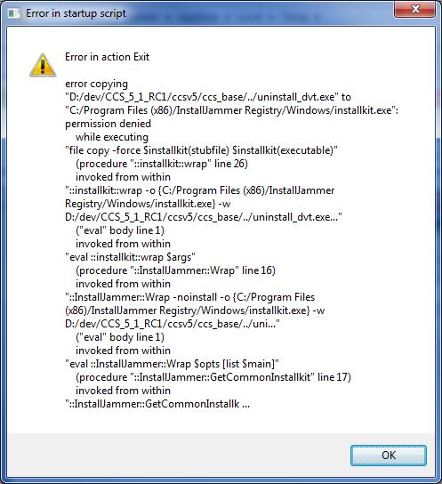

  • Come on.  Silence?  Okay, you can skip the emulator read error.  How about the Out_Of_Seq Data warning and the logger memory sizes?  Those should be easy to answer.

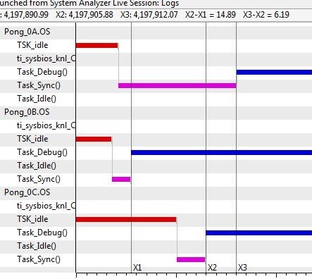

    (first thread starts around 510 us, and the other two start 634 us -- NOTE: when loading from the binary, the Pong_3B core does not show any data... it did when I captured it.  Guess I found a bug?)

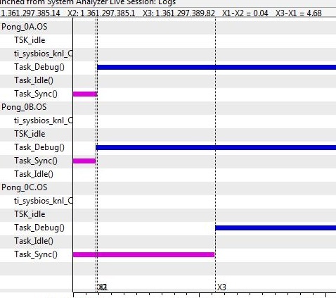

  • That would be great.  This timing analysis, particularly across cores, is critical to my application, so I by no means mind any type of "hacking" I may need to do to get it working properly.
  • Also, maybe this is just a bug in 1.0 and has been resolved in 2.0 -- meaning I am out of luck -- but is there some special trick in getting the Execution Graph to sort the tasks in a consistent order?  (The little up arrow only sorts the cores, not the tasks within.)
    Pong_0B: Task_Idle(), Task_Sync(), Task_Debug(), TSK_Idle()
    vs.
    Pong_0C: Task_Idle(), Task_Debug(), Task_Sync(), TSK_Idle()
  • Alex,
    Currently the graph only sort at the channel level (which in this case is the CPU). We'll file an enhancement to extend sorting to the state (in this case the task) level.
    If this is critical to your analysis we can look at getting you a patch for CCS5.1 when the enhancment is available.
    Imtaz.
  • It's not critical, per se.  It just makes it more difficult to visually inspect the Core-to-Tasks load balancing.  Admittedly, though, until I can get the timestamp module working, it's sort of a moot point. :-)
  • Hi Alex,
       I've created a new ti.uia.family.c64p.TimestampC6474Timer module - you can install it as follows:
    • make a copy of your uia_xxx\packages\ti\uia\family\c64p folder and save it as a backup, in case you want to revert back to it later

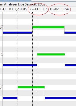

    Update #1
    So I was too excited to wait as you suggested, and here are my findings:
    (disturbing news) I had to increase my LoggingSetup.sysbiosLoggerSize to 2 MB to stop losing packets and getting (still) those Out_of_Sync warnings.  (I chalk those Out_of_Sync warnings to the record loss, though, unless you say otherwise.  With the 2 MB buffer and zero packet loss, I no longer get those warnings ever.)
    (disturbing news) [Eclipse Related] I can only make two runs (run... halt... restart [app and then MSA]... run... halt) before CCS crashes complaining about a Java heap error.  (And yes, I have already increased my heap size to 512 MB in the eclipse.ini file.  I'll try 1 GB.)
    (good news) My test task now is synchronized across all three cores.
    (great news)
    The timings are spot on! (as far as I can tell, give or take a few hundred microseconds)
    Interestingly, setting LogSync.globalTimestampCpuCyclesPerTick to 1 rather than leaving it at its default value of 6 seems to make no difference as far as timing measurements go (task measures 11.17 ms which is about right and the sleep time measures 99.84 ms which is about right [should be 100 ms])  But it does make a difference in the inter-core task synchronization: with 6, their start times are staggered by a few hundred microseconds (which is what I would expect, I guess), but with 1, they all start exactly at the same time (which is not very believable).
    So, in summary, the timing is now fixed (thanks to your new Timestamp module... THANK YOU!), but the synchronization still seems a little bit off.  It's probably good enough, though, I don't know.  I have 20 ms to do a lot of data processing and analysis (hence the need for the 9 total cores), so being off even by a millisecond can be detrimental.  Still, though, even "as is," this is of enormous benefit to me, and I thank you wholeheartedly for all the effort you have put into this.

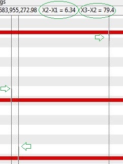

  • Okay, I have been trying to figure this out all morning, and I'm stumped.
    As I reported above, with your new UIA C6474 timestamp module, everything was working hunky-dory this weekend on my platform at home.  Today, though, here at work--same platform, same app, same CCS tools, same UIA patch [provided by you]--there are no records being record at all for any task other than Idle task I spawn that runs at the end of the test sequence.  This is in the Execution Graph.  Look over at the message log pane, though, and everything is executing properly and in order.
    I'm attaching my MSA session and .cfg file.  You didn't answer my question above about whether or not you are even able to load these, but I hope you can so you can see what I mean.  If not, let me know, and I guess I post screen shots.

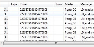

    I think I figured out the problem, but I do not know the cause.
    1. The Execution Graph always goes from 0 ms to 100 ms, exactly, every time.  (symptom of problem)
    2. I just inspected the log messages more closely, and every single timestamp is identical.
    So it seems the timer I am telling the GlobalTimestampTimer object to use (TimerInstance_Timer5) is not being initialized.
    Dumb question, but since it was working this weekend without me doing anything special, maybe not so dumb:  Will the GlobalTimestampTimer object create the timer, or do I need to do it myself?  Like with a clock object, is there a way to cite an owner so all three cores don't try to initialize it at the same time?

  • This timer still has me stumped.  Went home, and again, everything worked great.  Back in the office now, and nothing works.  Exact same code and hardware, so the only culprit left is maybe my UIA installation.
    I have BIOS sharing timer 3 across all three cores, and I have the timestamp module using timer 5.  I don't have a screenshot of my log from home, but here, you can see that the timestamps are erroneous:  same value across the board, and the value is way too large.  (This is after a fresh power-up, i.e., values should be starting around the 10,000,000,000 range tops, not 9,223,372,036,854,775,808.
  • First run, so I say this with trepidation, but I switched to Timer 4 and switch back to JTAGSTOPMODE mode, and everything somewhat started working again.  The only snag is now I am getting those Out_Of_Seq Data warnings again.
    Update:  I found the culprit.  It was Timer 5.  My colleague, who independently wrote our little boot-loader, was having BIOS (bootloader uses BIOS5... don't ask) use Timer 5 as its kernel timer.  So I guess this is just an issue of the timestamp module not properly reinitializing it.

    Re: timestamp values of 9,223,372,036,854,775,808
    This equals 0x8000000000000000 - I'll check to see what significance this has (might be due to no sync point event being detected.)
    More later...

    May be hard to make out, but...
    Edit:  (At home... haven't applied your new patch or .cfg setting yet.) Okay, I guess the alignment wasn't as close as I thought:
    But 80 us vs. 2 us actually has huge impact on my analysis as part of my load balancing deals with pre-processing the data we are receiving externally every 200 us. So my question still stands.  Is this timing accurate, and if so, why aren't they aligned (since the kernel HWI tick on all cores is being driven by a single, shared interrupt line).  If not accurate, to what degree of accuracy should I expect?
    BTW, BIOS's timers (kernel and now timestamp) are the only HWI's in the system active at the time of the above snapshots.  But even if the interrupts all happened at the same time, I wouldn't expect 2 us worth of latency, much less the 80 us I get with the new patch.
  • I struck out my reply above because I am chasing a red herring here.  My apologies.  Because of the way the Execution Graph cuts off (clips) the task name, I did not realize until I accidentally moved my mouse over it and saw the tooltip that the kernel tick task was not the core HWI task, but just the worker task, and it only seems to be called when the system is idle.
    (Sorry for the width.  Click it to see the full image.)
    It's still puzzling, though, why the new timer settings shift things.  The absolute values should change, sure, but relative to each other, since the application did not change, neither should have their relative offset.
  • After further analysis, it's clear that the cores are still not fully synchronized.
    8863.Logs_and_Graph.zip (.csv export of above graph and also event logs)
    With respect to the Task_Debug() task, there is an IPC notification event generated at the end of Task_Sync() making it impossible for Pong_0B (core 1/slave) and Pong_0C (core 2/slave) to begin before Pong_0A (core 0/master), yet the above shows differenently.
    Also, if you review the log messages, (filter on printf event and "Task_Sync" in the message), whether you sort by timestamp or by sequence ID, it is showing the slave cores receiving notifications before the master even sends them.

       What is the frequency of the CPU clock on your board?  Also, what platform file are you using (e.g. ti.platforms.evm6474)?
      Brian
  • 1 GHz, and the platform is a custom platform.  But the platform just defines the device (TMS320C6474),  frequency (1000 MHz) and memory layout (not applicable to this problem).
    So even making the synchronization tighter by polling memory flags and putting EVERYTHING onchip (to remove DDR resource contention), the graphs line up better (21 us max differential [see image below]), but the out of order log events still concern me. (Having a received event logged [both by timestamp and seqID] before it is actually sent just seems wrong to me.)
    3288.Logs_and_Graph.zip

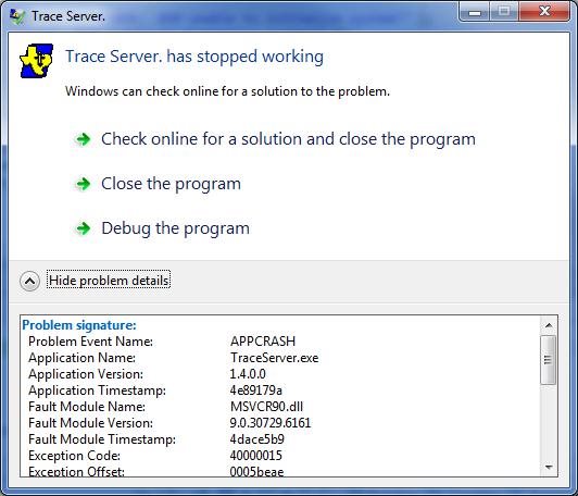

  • I was going to start a new thread and report this as a bug, but Miguel doesn't seem to have a problem (link), so it must be must my system.
    I've tried twice now to install RC1, once without any prep-work, and again after uninstalling all things TI (hoping it was a conflict or something).  Both times, though, the UIA component is completely broken in that I always near instantly get a Corrupted Data error once I start running my application:
    Exported Log of Above:  0726.UIA_CorruptedData.log
    I have to completely uninstall RC1 and then reinstall M7 to getting things working again.  (I can't install M8/8.5 since they don't recognize the NDK package.)
    I'm running under Windows 7 (64-bit) if that makes a difference.
    Oh, and I tried creating a new workspace, too, but that didn't make a difference.
    Update:  It's the Silicon Real-Time Mode, or, at least, it's related.  I have that off by default (because it's been buggy ever since CCSv.4), but I just noticed that when I first open an MSA session, it gets auto-enabled.  If I disable it again, things change.  A couple of times, it actually worked fine.  Other times, it was a different data corruption error (complaining about the payload size), and other times CCS just completely hangs (indefinite hourglass).
  • Update #2:  Alright, so unlike this weekend, I was able to switch back to my M7 install without uninstalling RC1, and everything is working fine again.  Same hardware, same JTAG emulator, same project, same workspace, and UIA 1.00.02.22 gives me data corruption and UIA 1.00.01.17 doesn't.
    Next test, I'm going to copy UIA 1.00.01.17 into my RC1 install directory, switch to it, and see if the problems persist.
    Update...
    Using UIA 1.00.01.17 under RC1, now the Trace Server crashes every time I launch the debugger.  I can close it and continue, but I still get the Data Corruption error, undoubtedly due to the now non-existing trace server.
    I guess I am stuck with M7 forever.

    I was not able to reproduce the crash with the workspace and other cache files. Will continue to dig down deep and see if there is any other way to reproduce this. There may be some PC specific dependency here (like firewall or antivirus software)......... not fully sure until reproduce it.
  • By any chance, were you using CCS 3.3 and CCS3.3/cc/bin is in your PATH? Just a query.
  • I do have CCS 3.3 installed, but no, it's not in my path.
  • Ok thanks.
    Is there Windows firewall active in your system?

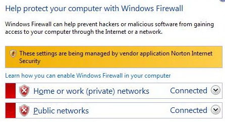

  • Not Windows (I usually turned that off), but I run Norton Internet Security.  I'll check when I get home.
    (In case you haven't been able to infer this, I work 14-16 hours a day, both here at work and then resume when I get home.  To reduce risk, I generally only upgrade at home on a weekend, and only if everything works out do I upgrade my office workstation.)
  • Yes, here at home, Windows Firewall is disable and is replaced with Norton Internet Security, or so Windows tells me:
    BTW, I looked at my PATH variable here at home, and though CCSv3.3 wasn't there, I see that CCSv5.1(M7) put itself there in my User PATH.
    As one final attempt, I now completely uninstalled M7, manually uninstalled DVT (since all of CCSv5.1 installers since at least M5 always fail near the end and never finish the uninstall), removed M7 from the path (since the uninstaller didn't), and then installed RC1 again.  Still get the Trace Server crash.  Still get the corrupted UIA data.
    In case it helps, here again are the directories you requested above, taken immediately after the crash and data corruption.  I'm including the export of Eclipse's error log (about the Data Corruption), too.
    6888.TI-trace.zip
    I then disable the firewall, and Trace Server no longer crashes, but that be because it crashed previously and the driver is disabled (and I need to reboot, which I can't right now since I'll lose this post).  But interestingly, at least this first run, UIA didn't error out, but I did get weird results: 3 gaps, out_of_seq warnings,and the last entry is (null) and the timestamp and sequence # are way wrong.
    8686.MSA_Live_Log.zip
    I'll try rebooting now and then also disable the Antivirus and post back in a minute.
  • Rebooted, and again the trace server still no longer crashes.  I'm using Norton Internet Security 2010 (v.18.6.0.29).  I guess it's silently (I get no pop-ups asking me yay or nay) blocking your Trace Server, and your Trace Server gets annoyed and dies. :-)
    Unfortunately, though, this time, I got the usual UIA data corruption.  I have a lot of work to do, so I guess I will uninstall again and go back to M7. :-(
    Oh, and though I am getting way off-topic in my own thread, each time I uninstall RC1, I always get the following error (no option to copy text, so sorry for the big screenshot):
    And yes, I'm in the Administrator group, and I have UAC disabled.
