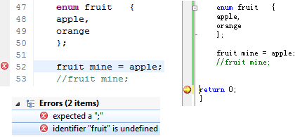

I would like to ask a question on enum on C6000 compiler.
A declaration following definition of enum type and variable, which are completely legal in Visual Studio 2008, got error on C6000 compiler.
I have also tried the -kr_compatible option but it didn't solve the problem.
Why this happens and how should I solve it?

    No, the compiler is not in error.
    The code you have presented is valid C++ code, but it is not valid C code. No doubt you are operating Visual Studio in C++ mode.
    You need to declare this variable as follows, or else use C++ mode:
    enum fruit mine = apple;
  • Another way to handle that in C is to use a typedef:
    typedef enum fruittag { apple, orange } fruit;
    fruit mine = apple;
    enum fruittag yours = orange;
    The fruittag identiifer is optional.

    Both your solutions worked, thanks very much.
