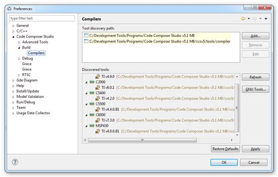

    You can check which version of the compiler your project is set to use.  Right click on your project and select properties.  Click on CCS General.  In the case of my project below the project is set to use the 3.3.3 compiler but is actually using the 4.0.0B1 compiler as this CCS installation is not aware of where the 3.3.3 compiler is installed.
    You can tell CCS where additional compilers are installed by going to Window -> Preferences:

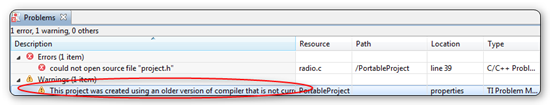

    There should be a warning in the problems view:
    However you are likely not going to see this until after your build and if there were no errors you may not even look (especially if you were hitting the bug button to build and then launch the debugger).
    Currently CCS will halt the build if the compiler being used is much older than the one the project is set to use.  If it is just a little bit older it gives a warning or if it is newer it just gives a warning.  There has been some thought to making the behavior user controllable.

  • The screen capture I sent with the warning is from 5.1.0 M8.  That one is a bit newer than the build you have installed.  We are actually installing the 7.3.0 compiler now as the default for C6000.  My project situation was the same as yours.  CCS had a newer version but my project was configured to use an older version (which could not be found).  CCS used the newer one but gave me the warning in the problems view.  It is real easy to miss the warning though.
    When CCS forgets where your 7.0.4 compiler is does the location entry disappear from the preferences dialog?
    John
  • The directories that CCS searches for compiler locations are stored in \ccsv5\eclipse\configuration\ccs.properties  At least that is where it is stored in the latest 5.1 builds.  It got moved there so that they wouldn't get wiped if someone cleans out the workspace.
    If you don't have that file you may want to try updating to 5.1.0 M8.5 and see if that helps with the problem of the directories getting lost.
