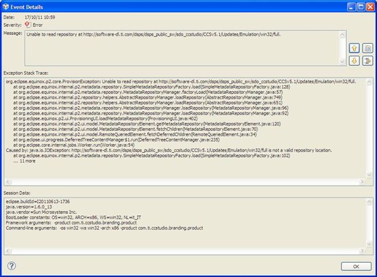

I see the problems already issued on CCsv4 e CCSv5 are still present for release Candidate CCSv55.1 RC1.
Update features inside IDE do not operate. Almost all sites are not reacheable.
  for example selecting Help->Install New Software->Work With
   TI Emulation - http://software-dl.ti.com/dsps/dsps_public_sw/sdo_ccstudio/CCSv5.1/Updates/Emulation/win32/full
  you get
   Unable to read repository at http://software-dl.ti.com/dsps/dsps_public_sw/sdo_ccstudio/CCSv5.1/Updates/Emulation/win32/full.
   http://software-dl.ti.com/dsps/dsps_public_sw/sdo_ccstudio/CCSv5.1/Updates/Emulation/win32/full is not a valid repository location.
The same is true for all "work With" options and obviously for Help->Check for Updates

  • Hi Alessandro,
    yes I am aware there are other people having this issue.  Unfortunately it is not something I can reproduce on my RC1 installation,
    Can you please zip and send any error logs and .dmp files generated?  Can you confirm which installer you used (lite or full)   What platform are you using?
