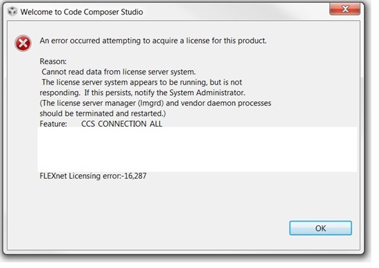

Since using the F28335, I have reinstalled the tools so that the target configuration would show the black hawk emulaters.  Although I can not yet use the license from the server our IT guy setup (he can't either) CCS appears to intitially think it is licensed in that it shows "C/C++ - Code Composer Studio (Licensed)" on the CCS banner line of the window.  At one time while using the tool version supporting the XDS100 on board emulator only, I had mistakenly used the 30 day license, and when it expired, I used a TI generated license file for that version of the tools.

If I go the HELP->Licensing Options, I get the following error dialog.  Server name / path have been removed.

  • I think I first need to solve the issue with the CCS Floating License not getting served to my host.  See the message from CCS below:
    I know I can not use the debugger without a license being served.
    John
  • Hi John,
    I think the issue is you were using a Free limited License.  You were using and XDS100 and this was allowed in this license type, however other emulators are not allowed.
    So when you try to switch to a blackhawk emulator, this is why the license becomes invalid.
    Please see this page, in particular the part I cut and pasted below.  Please keep us informed whether this is most likely the issue.
    Lisa
    http://processors.wiki.ti.com/index.php/Licensing_-_CCS
    Free Licenses
    We have a number of different free tools options available in CCS.
    Evaluation License: When you download CCS from the web you can choose to generate a time limited evaluation license the first time you run the product.  This will allow you to use all of the features of CCS for a set peroid of time (30 or 90 days depending on version) so that you can evaluate TI devices and tools but at the end of that time period it prompt you to provide another license.
    Code Size Limited (MSP430): There is a 16KB free code size limited license available for CCS.  For CCSv4 there is a separate microcontroller core image on the web.  For CCSv5 there is no separate download required.  With the code size limited license you can use all of the features of CCS, you can create production code but the object code size will be limited to a particular amount. In CCSv4 there was a 32KB limited version available for C28x, this is no longer available as you can instead use the free bundle license wiht XDS100 that has no limit.
    Bundle License (Free Limited License): We include a free version of CCS with many of our community boards, DSKs and EVM (Evaluation Module) kits.  These kits come with a development board, software and CCS.  The CCS will only work with the onboard emulation on the board.  This free license can also be used with simulators or with XDS100 class emulators as well as the XDS560v2 mezzanine card available in C6000 multi-core EVM bundles.  You may use this version to create production code. Download the DVD image to use this license. This license will work with eZdsp kits. DO NOT USE THIS WITH EZ430 KITS
