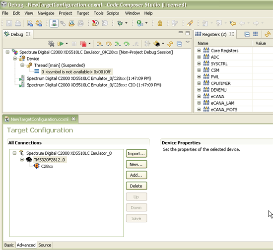

    Make sure your target configuration ccxml file uses the f2812 device xml file. How can you confirm this? In the advanced tab of target config editor and see if there is an additional node (TMS320F2812_0). This confirms that the device XML file is being used.
    EXAMPLES
    GOOD (being used):
    BAD (not being used):
    If you use the basic tab to pick the connection and device, it should automatically use the device xml file.
    ki

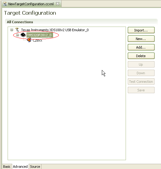

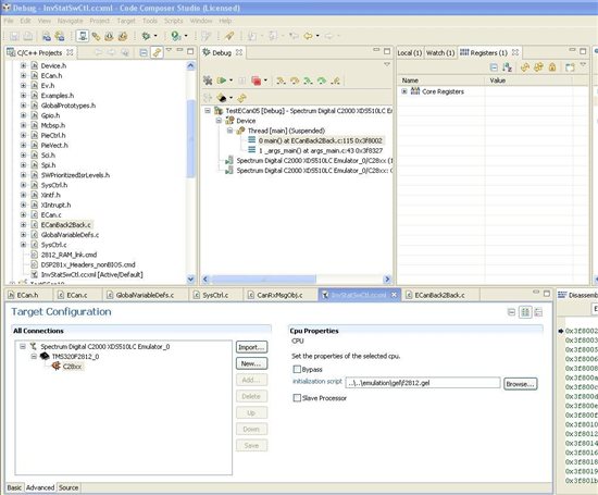

    I followed your steps to the screen reproduced here:
    As far as I can tell, I always had TMS320F2812_0 specified
    in my ccxml file, and as you can see, I still have only
    'Core Registers' in the REGISTERs window.
