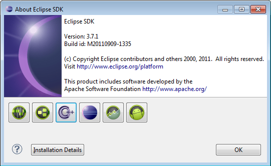

Hi all,
I've installed this new release as a plugin into an existing Eclipse installation. However I'm not able to activate the license nor create a new CCS based project. I've also checked the Installation Details and CCS components are well installed. Here's my about Eclipse dialog.
Should I use the Eclipse 'Classic' version for the CCSv5.1? How could I fix this?

    CCS is using C/C++ developers version of eclipse as a baseline. I think the main thing that would have been missing from SDK is CDT, which it looks like you have that installed. It is still possible that there might be a dependency that is missing. Could you check whether you have CCS Edit and CCS Debug perspectives available in WIndow->Open Perspective. Also, could you send your configuration information (Help ->About Eclipse -> Installation Details, then click on "Configuration" tab, there is a button at the bottom that allows you you save configuration information to a text file.
    ALso, it looks like you are using SR1 version of eclipse. There is a compatibility issue between CDT SR1 and CCS in expression view. There is a manual workaround to get it fixed. I don't have the link right now, but I'll dig it up once we get past this issue.

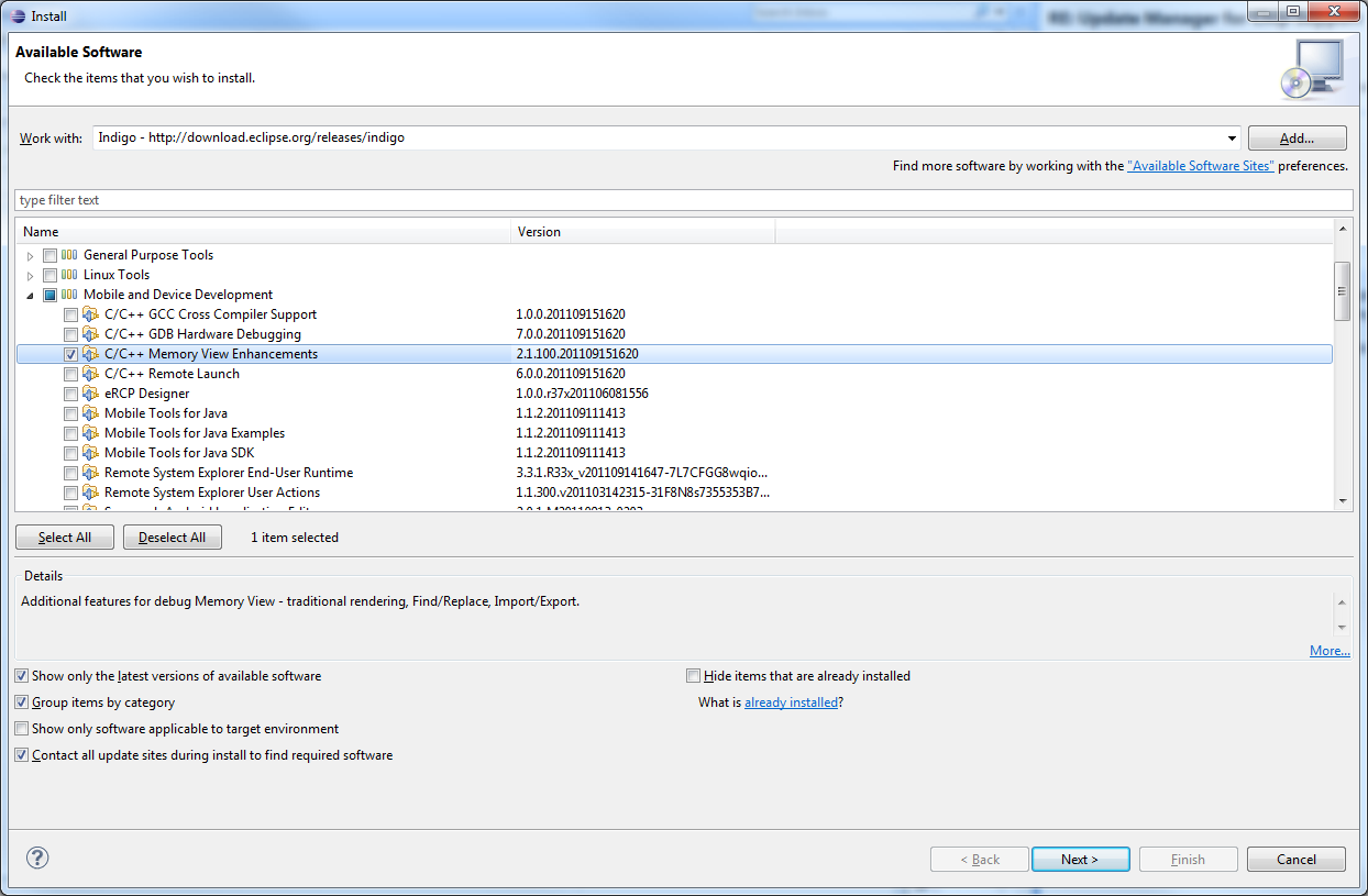

  • Gaston,
    Configuration files helped to identify the issue. CCS uses what is called a CDT EPP package. There few different EPP packages on eclipse.org that users normally download. It seems that CDT EPP package has a slightly different content for CDT then when you install C/C++ Development Tools through Install New Software.  The missing dependency causes CCS plugins not be installed. See picture below for additional feature that needs to be installed. Once you update this, you would need to re-run CCS installer. I have checked that using SR1 Eclipse SDK + C/C++ Development Tools and memory view enhancements package allows to install CCS plugins.
    Martin
  • forgot to add this is the issue that you will run into when debugging. There is a workaround provided in that thread as well.
    http://e2e.ti.com/support/development_tools/code_composer_studio/f/81/p/143113/517240.aspx#517240
    Martin
  • Martin,
    Thank you. Could you send me the Available Software dialog with better resolution? I'm not able to read it.
    Gaston
  • Hopefully nothing will be "shrunk" once I hit post. Just in case once you go to main Indigo update site you need to go to
    Mobile and Device Development category and then select "C/C++ Memory View Enhancements" feature.
    martin
