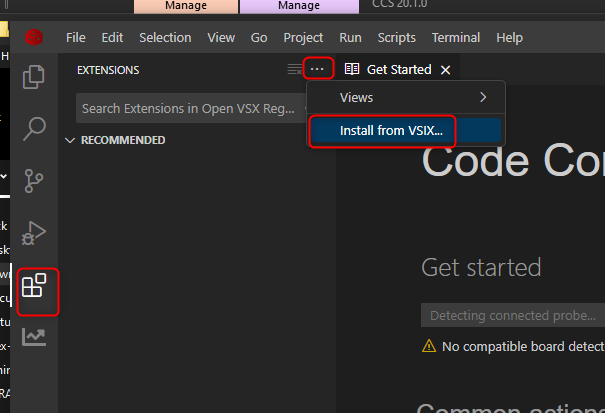

You can install the VSIX file via:
It is admittedly basic for some of our asm files but it doesn't have any issue that I had with some of the others I tried
