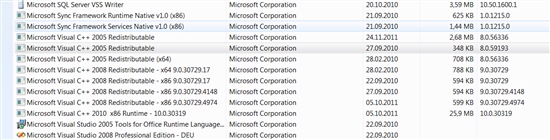

  • Hello Stefan,
    The .log that sent helped identify the issue. We have a couple of reports of this problem. The fix is to re-run "\baserepo\vcredist_x86_2005.exe" executable that is part of CCS install image. You may need to reboot the machine if there are pending OS patches.  We are not quite sure what the root cause is yet, but it appears that some event causes the libraries that are part of this run time distribution to be uninstalled or somehow removed from the OS.  Would you be able to provide some information as to your setup such as OS version, patches, maybe windows Event Log information? Any information that you provide might help in identifying what the root cause is.
    Martin
  • Hello Stefan,
    Could you also check if "Microsoft Visual C++ 2005 Redistributable - KB2467175" appears in your Add/Remove Programs list?
    Thank you,
    Martin
    i will try to help solving the issue so here are some infos of my computer system.
    OS: Windows 7 professional with Service Pack1
    System: 64Bit
    I made a screen of my installed Progs before i executed  vcredist_x86_2005
    after execution Microsoft Visual C++ 2005 Redistributable - KB2467175 appears here.
    and CCS also starts now.
    hope this helps dont hesitate to ask for further information
    greetz
    S.Fischer
