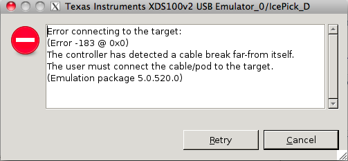

This is another error one of my colleague is getting when he tries from a different system:
Error connecting to the target:
(Error -183 @ 0x0)
The controller has detected a cable break far-from itself.
The user must connect the cable/pod to the target.
(Emulation package 5.0.520.0)

  • The Error -151 is something I've seen in the past. One thing is to check the EEPROM is programmed correctly:
    http://processors.wiki.ti.com/index.php/XDS100#Q:_How_can_I_check_if_the_VID.2FPID_for_the_EEPROM_are_programmed_correctly.3F
    Also you can try running dbgjtag to run more JTAG diagnostics. You can run it by pressing the 'Test Connection' button in the target configuration tool

  • The issue is solved. Since the board is set up for remote access, so there were concurrent accesses on the host machine (when the host machine had a trial version of CCS), which was the reason for this error. Thanks for all the help.
