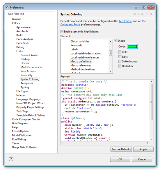

Syntax coloring is under C/C++ -> Editor -> Syntax Coloring
If you want to change function name coloring then change the settings for "functions".
Below I have changed functions to be red and you can see the call to "john" is red.
