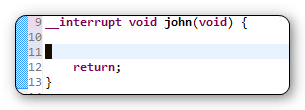

  • Also, the compiler has a problem with __interrupt ... see attachment.  What is strange is that it compiles fine ... no errors or warnings ... but the question mark on the left edge, along with the squiggly line under __interrupt indicates there is a problem
  • There is no version 5 of the MSP430 compiler.  4.0 is the latest stream.
    What build of CCSv5.1 are you using?  There was an issue with the dynamic syntax checker and the __interrupt keyword in the beta releases but that is not present in the GA release.

    Can you check the language mappings for your project?  It is probably not using the TI settings.  It should look like this.  If it does not you can click on the Add button to set it up.
    Did you directly open a CCSv4 workspace in CCS 5.1? If so, you may encounter such syntax errors.  Right-click on the project and go to Build Options --> click on Show Advanced Settings --> C/C++ General --> Code Analysis -->Launching, and make sure that both checkboxes "Run with build" and "Run as you type" are unchecked. That should make the syntax error go away.
    Moving forward, it is best to open a new workspace for CCS 5.1 and import your CCSv4 projects into it rather than directly opening a v4 workspace in v5.
