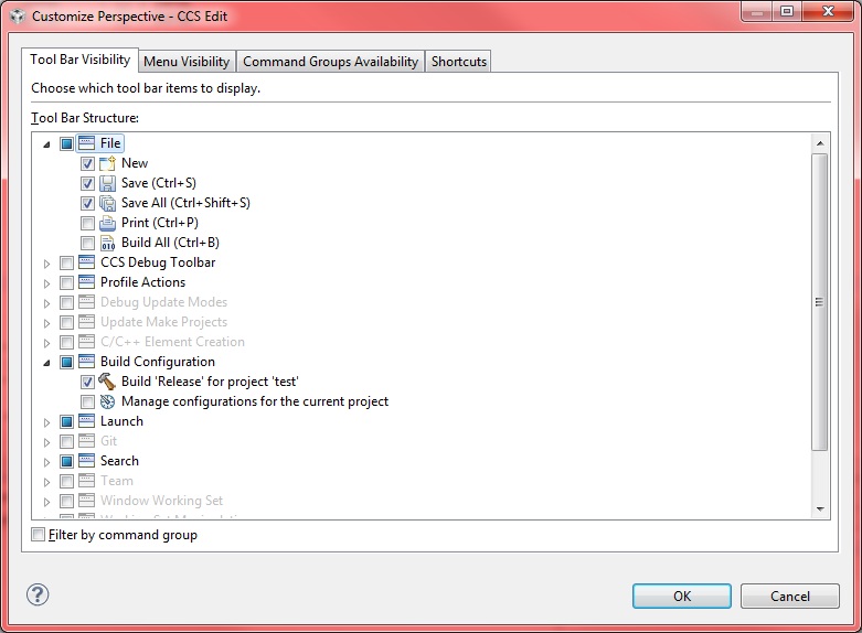

I upgraded from Code Composer 4 to Code Composer 5 (MSP430 code). The compile icons for Code Composer 4 were displayed along the top ... don't see them for Code Composer 5.  There were two icons ... one for compiling the code that has changed ... the other for compiling all files.

    do you mean build?  Have you noticed the hammer with the drop down menu in v5?  This is the build button in v5.   Could you send a screenshot of the button you can't find?  Have you tried a right click on the toolbar to customise it?

  • Yes, build ... and rebuild ... the blue icons on the attachment.  I did try customizing ... I see Build All which is probably similar to Rebuild ... don't see build which compiles only the file that has changed.

    the hammer is build, but there it is tied to a configuration - ie debug or release.  If you need more than this, you will likely have to right-click and customise a little.

    actually the default (Build Project, Build All etc) is actually always an incremental build that will only build the necessary files.  The difference between build project and build all is that build all will build all projects in the workspace.  In order to do a rebuild of everything you would actually have to do a clean first.  So the build button should be fine for you.

    Build Project - incremental build of selected project.  This only builds files that have changed as you wish.
    Build All - this is the same as build project, the difference is that it goes through all projects in the workspace.  It does an incremental build on each project only building changed files.
    Clean - removes information from the previous build.  After a clean all files will need to be rebuilt.  Clean + Build Project = rebuild.
    I hope this helps.  You should be able to add these to your toolbar.

  • Hi Clyde,
    the difference between "build project" and "build all" is the following.
    Build Project - only builds the currently selected project
    Build All - applies to all projects in the workspace
    Both, as I mentioned do incremental builds and only target changed files.
    I could not find the clean either - you may have to consider a keyboard shortcut.   Build project is the hammer button, as I mentioned before.  If you also wish build all to be there you can add it as per my screenshot below.

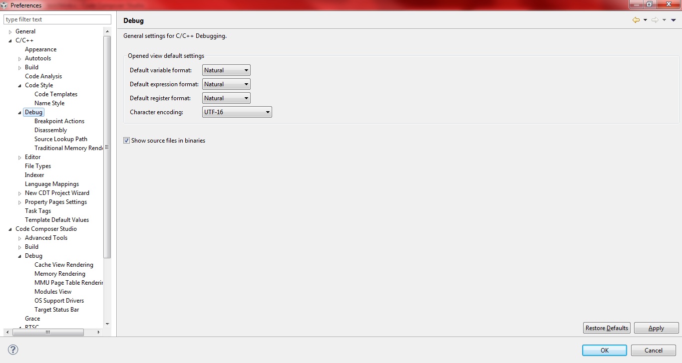

    What does one set so all Values in Variables and Expressions are automatically displayed in hex?

  • Hi Clyde,
    Please do ensure you use the CCS perspectives as John mentions.   Regarding your hex format question ... the attached screenshot should be self explanitory and you can look at Window->Preferences->C/C++Debug.   And yes, many of these items come from the fact we are stock eclipse based.
