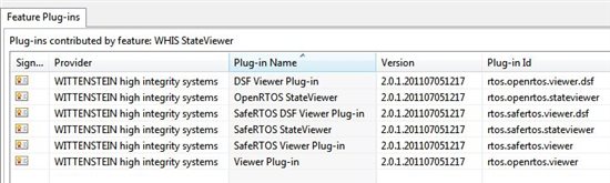

Has anyone been able to get the Safe/OpenRTOS StateViewer to work in CCS v5.1? I have a project using FreeRTOS and have been unable to make this plugin work. I had previously tried the plugin with CCS v4.x with no luck, but after some web searching, I determined that the plugin was incompatible with the version of Eclipse used.
I have StateViewer version 2.0.1 installed (full details below) and CCS 5.1.0.0900. I have set configQUEUE_REGISTRY_SIZE (to 10) and tried setting and unsetting configUSE_TRACE_FACILITY. Any help here would be appreciated - would love to have freeRTOS-aware debugging.

    I can see that the FreeRTOS globals and data structures have debug symbols. For example, I can use the Expressions window to view xTickCount, pxCurrentTCB, or xQueueRegistry.I have tried viewing ALL 8 different versions of the Stateviewer windows (OpenRTOS Tasks, OpenRTOS Tasks (DSF), SafeRTOS Tasks, ...) and all of them are completely blank when I stop my code (the DSF windows have columns with headers, but no content).
    Have you been able to get this to work? Is there a compiler option that is to blame here, maybe a dwarf version or something like that? I'm really curious if anyone has used this plugin with CCS.
