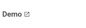

  • Hi Mark,
    I would recommend taking a look at Componnets help for gc-widget-dialog, In GC Designer choose Help->Component Help-> Components V3
    Find the gc-widget dialog and select it to see examples. You can then open the demo page by clicking on button below
    Once you have the demo in separate browser tab, open Browsers Developer Tools to see the implementation of the demo ( once Browser Developer Tools is opened type CTRL+P to open the file and enter "index.html", it will show the code snippet that you would need enter/add to your .gui file.
